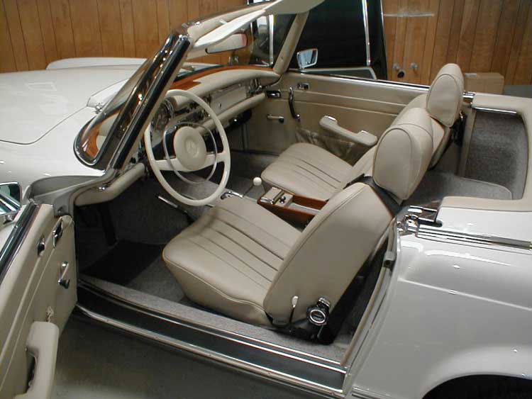

As far as I know, there are only three interior components that you can choose to have in ivory vs. black; steering wheel, shift knob and seat lever tips. Although they may be more readily available now, last year when I did my restoration the automatic shift knob was nearly impossible to find but I did get one from Van Dijk www.classicsl.com
Back to your question; is an ivory shift knob correct for a late 230? Not sure if it's correct, but IMHO certainly a desirable choice to have these things match when the steering wheel is ivory. The shift knob was 28,57 Euro (about $34 US) and it seems like the seat tips were around $15 US.
The attached photo includes all three of these components.
