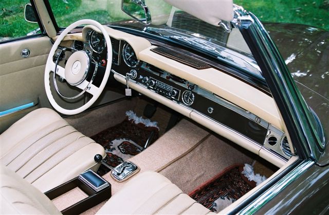

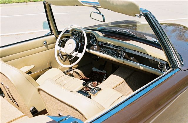

Diane -
If this will help, here are two shots of my original 121 Cream Tex 230SL interior.  The first was taken in direct afternoon sunlight, the second was on an overcast day.

Is seats leather?  Mine look the same I think.  121 looks closest to mine except mine is leather.  Still haven't found the seats in correct color in leather.  Will try to attach picture.  Thank you Diane
