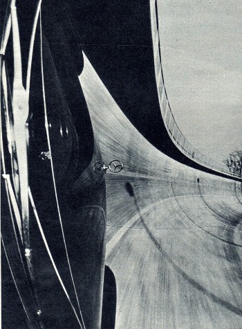

Who would like to try this with their Pagoda?
Download Attachment: MBTest.jpg
68.96 KB
Los Angeles
Chad
Re: how fast should you drive these cars?
« Reply #15 on: October 26, 2005, 21:41:15 »
What is that car?  It's not a 6.9.
-CD-
1967 230SL, 113.042 10

Hello Chad,
By the looks of the chrome wipers and the vent with windshield washer, it would have to be pre-1968. Possibly a W109 6.3 sedan or another era W110, W111, W108, W109, sedan. Could also be a coupe or convertible (W112, W112) of the same vintage.
