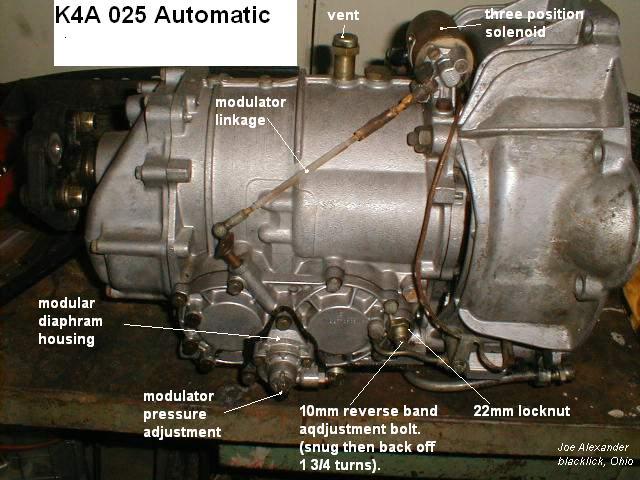

Don't despair yet.  There is a 22mm lock nut for a 10mm band adjustment screw for the reverse band which comes loose and causes these symptoms.
The adjustment bolt can be re-set and the 22mm lock-nut re tightened. Turn the 10mm bot in until it is just snug, then loosen it up 1 3/4 turns and tighten down the 22mm lock nut.
Refer to my photo below.
Download Attachment: K4A 025 Automatic.JPG
60.99 KB
« Last Edit: September 30, 2005, 20:37:33 by ja17 »

Are there any secrets to accessing the adjustment bolt/nut?  It's a tight fit, and given that I do not have a lift or anything, just ramps, things are pretty tight.  On the plus side, nothing is loose - but maybe in this case that's not so good.
More symptoms, to see if that adds to the diagnosis here:
1 - Fluid level is spot-on.
2 - When cold, it takes a little bit, but reverse does engage, and stays okay, so long as I dont rev the car, in which case *something* chatters.
An adjustment would seem plausible, if only I could loosen the 22mm nut.  Ugh!

If the 22mm nut is not loose there is less chance it may be an easy fix. However, I would loosen the 22mm nut and just snug the 10mm adjustment, then back it off 1 3/4 turns.
The fluid level should be checked when the engine  is warmed up it must be running in park and on perfectly level ground.
Sometimes the valve body in the transmission becomes loose causing an internal pressure leak.
If the adjustment does not do the trick the next line of action is to remove  the transmission pan and check for debris.  Be prepared to replace the cork gasket, the filter and fluid. The valve body can be re-tightened when the pan is off.
