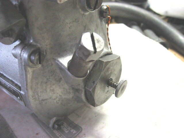

« Reply #5 on: June 16, 2003, 22:24:25 »
Hi Daryl,
I don't think my dipstick was ever red (see pic).  Re-filling is easier through the oil breather cap on the I.P.  It just unscrews.  It's all one big open area inside, so you can basically re-fill it through any convenient hole.
