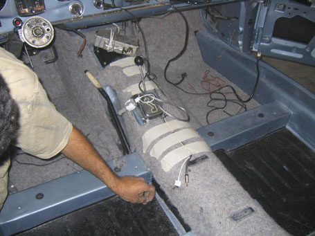

« Reply #9 on: September 16, 2005, 02:29:28 »
Salamat Mohannad,
The Dynamat is used mainly for sound dampening and heat reduction. Contact  3M they have an equivalent.
You can use Tar Rolls insulation (ZIFT) that is used in construction on the roof tops of buildings for water proofing. If they do not have the stuff in Dubai
Attached is a photo of my car when I was doing the insulation . The black mats are the Dynamat which goes on the metal floor, then the insulation padding, then you put back the carpet.
If you need any info call me
Regards
Malek
Download Attachment: Pic 1.jpg
60.11 KB
280SL 71- Light Blue-/Blue
190SL 61 - Ivory/Red
