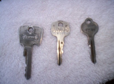

Hi Eryck. Here are mine (sorry about lousy camera work)...
Keys Download Attachment: 000_0220.JPG

James - thanks for the super quick response.
Ooops....mine look the same.  They look pretty bad for original keys!  Not even a logo on them and they all look different.  Looks like I will just polish mine up then....thanks again for the help.

Yes mine could use some sprucing up. Since I have two other sets, I keep these in my desk, so never thought much about that.
The large one is Niemann and other two are Ymos. Unfortunately, along the way someone changed my gas cap so I actually have a 4th key for that.

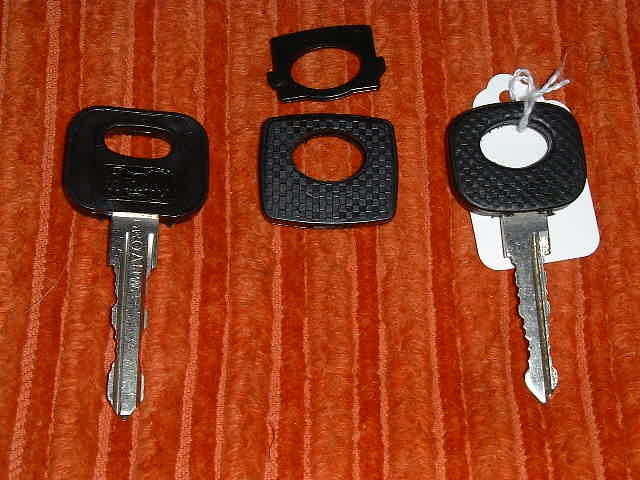

This is what the original keys should look like. The black plastic top is available from your MB dealer P/N 000 766 44 06 and installs over the metal key blank. The material of the original keys is steel. I got German keys from Broadway Locksmith here in town, but their supply is limited to a few blank numbers. These keys have the plastic top already attached, but on close examination it does not quite match the original MB in shape or texture. The top from MB is the real thing, the key on the left is the one from Broadway Locksmith and it is made from steel (Magnet sticks to it)

You are correct (I assume) for the later cars.  However, Eryck's car is a '65 230SL, for which the keys shown in James' photo are correct.  The one on the left is the ignition key, the middle is for the doors and gas cap, and the one on the right is for the trunk (boot) and glove box.
