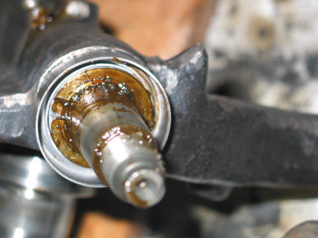

I took my kingpins to a machine shop asked them to fit it for me.  One side needs to be replaced for sure and someone had done the other side before so I asked them to check for me.  They told me the other side is in good shape so they did only one.
I took them home and tightened the end nut to 65 lb-ft on bench.  The one they did can't turn and the good old one turned fine.  I removed the lower carrier from both.  The one they did have a washer inside the carrier housing (photo 1) and the old one did not. Is this the compensating washer?   There IS a washer fitted to the brass bushing inside the steering knuckle on both kingpins (photo 2). Is that the compensating washer?

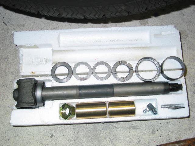

Photo 3 shows the new kingpin kit.  The round washer on the left most is bigger than the other two (all have different thickness).  Are the other two the thrust washers?
Can someone tell me exactly which one is the compensating washer?  Was my old "good" pingpin installed incorrectly?

the compensating washer goes on the bottom of the kingpin setup, between the lower trunion and the bottom of kingpin bushing.  it sounds like your old one wasn't installed properly (be sure the washer isn't just stuck to the bottom of the kingpin bushing).  the new kingpin setup needs a thinner washer, or more likely, the washer needs to be sanded down until the proper amount of torque on the bottom nut still allows the steering knuckle to turn freely.  There are also specs for the up and down free play on the kingpin - which is what the compensating washer is used to adjust.  I torqued mine until the steering knuckle started to bind, then sanded the thinnest washer until the kingpin/steering knuckle turned without resistence and the 65 ft lbs of torque on the lower nut.  doing this on the bench saves a lot of hassle...  be patient and get it right or the steering will feel dead and not return to center as it should....

the washers in the picture appear to be - from left to right - thrust washer, compensating washer, compensating washer and thrust washer.  the two thrust washers are much heavier than the compensating washers - the kits usually come with three compensating washers of differing thickness.  You only use one of the compensating washers on the lower end and the two thrust washers on top.  be sure to seat the lower thrust washer with the grease grooves pointed up and the washer seated correctly on the pin on the top of the kingpin housing.

Two thrust washers go to the top and one of the compensating washer goes to the bottom according to the book.  The left most washer in the picture is bigger and thicker than the two on its right.  Are you sure that is the thrust washer?  If the two smaller one are compensating washers then one of them needs to go to the bottom then.

Yes - from what I see in the picture, the left most washer is a thrust washer - the other thrust washer has the grease channels.  Both of the thrust washers are much heavier and seem to be hardened steel...  the compensating washers are much thinner and can be "easily" sanded down to fit....
