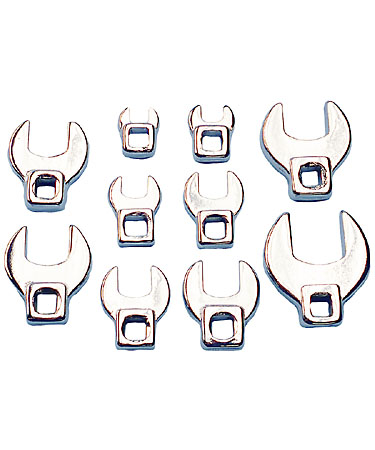

First of all, the annual/12k job of retorqueing (?sp.) the head is DEFINATELY a great excuse to get a torque wrench, and a nice one at that.  Just don't go near the Snap-On truck with your wallet.
Cees, I thought I was the only one to have to pop a couple of rocker arms off to put a socket on the ball stud (the first time I did it was by necessity, after rounding one off with a crow foot).
Just for clarity:
Download Attachment: Crowfoot.jpg
48.17 KB
Download Attachment: Hazet.jpg
4.44 KB
Re: Torque Specs for Head?
« Reply #16 on: September 07, 2005, 19:36:34 »
This is the type wrench for valve adjusting... they come in both 14 and 17.
 The offset allows for proper torque reading as rhe wrench c/l is the same as the adjuster nut c/l.
 http://www.samstagsales.com/images/hz2768-1.jpg
  • Posts: 7513
« Reply #17 on: September 07, 2005, 20:57:44 »
Hello Greg,
The second picture looks like two Mercedes Diesel Valve adjustment wrenches. ADalton's tool is one of the correct "deep jawed" crowsfoots. There are several very good special Mercedes Valve Adjustment tools made by several manufacturers like ADalton's or similar which work well. Deep or thick jaws and high quality steel is a must for this tool.
Harbor Freight sells a very nice "click style" ratcheting torque wrench for less than $20.00! It is 1/2" drive and seems to have stayed very accurate. I check it with my $250.00 Snap-on torque wrench.
enochbell
« Reply #18 on: September 08, 2005, 04:29:14 »
Yep, Arthur and you are right, and now I have ANOTHER tool I have to buy.  I have been using the Hazet long-handled wrench for years (they make a 14 and a 17, my 230sl takes the 14 and I was under the impression that the 17 was for later SLs and diesels?).  But the tool Arthur references looks like a winner.
Thanks, once again.
