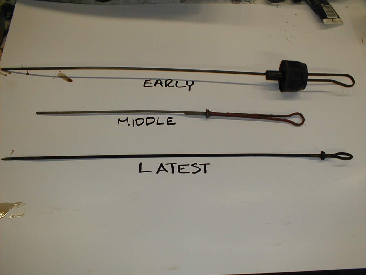

Hi, Bob,
I have the same dipstick (with air filter on handle) on my '65 230SL and it is correct.
See:
http://www.sl113.org/forums/uploaded/ja17/2003623233022_dipsticks.jpg

Re: oil dip stick marking 1966 230SL
« Reply #2 on: August 23, 2005, 16:53:51 »
Someone used an earlier oil pan maybe. I'm pretty sure by '66 they had a simple wand with a looped handle on the end. Crank case air filter type is used on first two or three years at most.

Hello Bob,
Yes the 230SL dipstick does have 220SE stamped on them.

« Reply #4 on: August 23, 2005, 22:40:24 »
Yes, I agree but I don't think that every year had them.

« Reply #5 on: August 24, 2005, 01:05:14 »
I have a '65 230sl, and the dipstick is like the middle one in Naj's picture. It even has the remains of red paint on the handle... but it says '230/250' on the stem. But my car was originally made for Germany-- I wonder if that matters..?

Hello WAQAS,
I think Dan is onto soomething here. The type of dipstick changed along the way. The change was not confined to model change (230SL, 250SL, 280SL ) but happened within the models.
Don't worry about having the right dipstick, the length and diameters of their tubes changed along  so only the correct one  of the three will fit.

« Reply #7 on: August 24, 2005, 13:02:47 »
My dipstick is stamped "230/250" & is of the "middle" configuration.

« Reply #9 on: August 25, 2005, 10:13:44 »
Oil dipstick with 220SE was used until Aug of 1965 then changed to omit the vent and filter.
