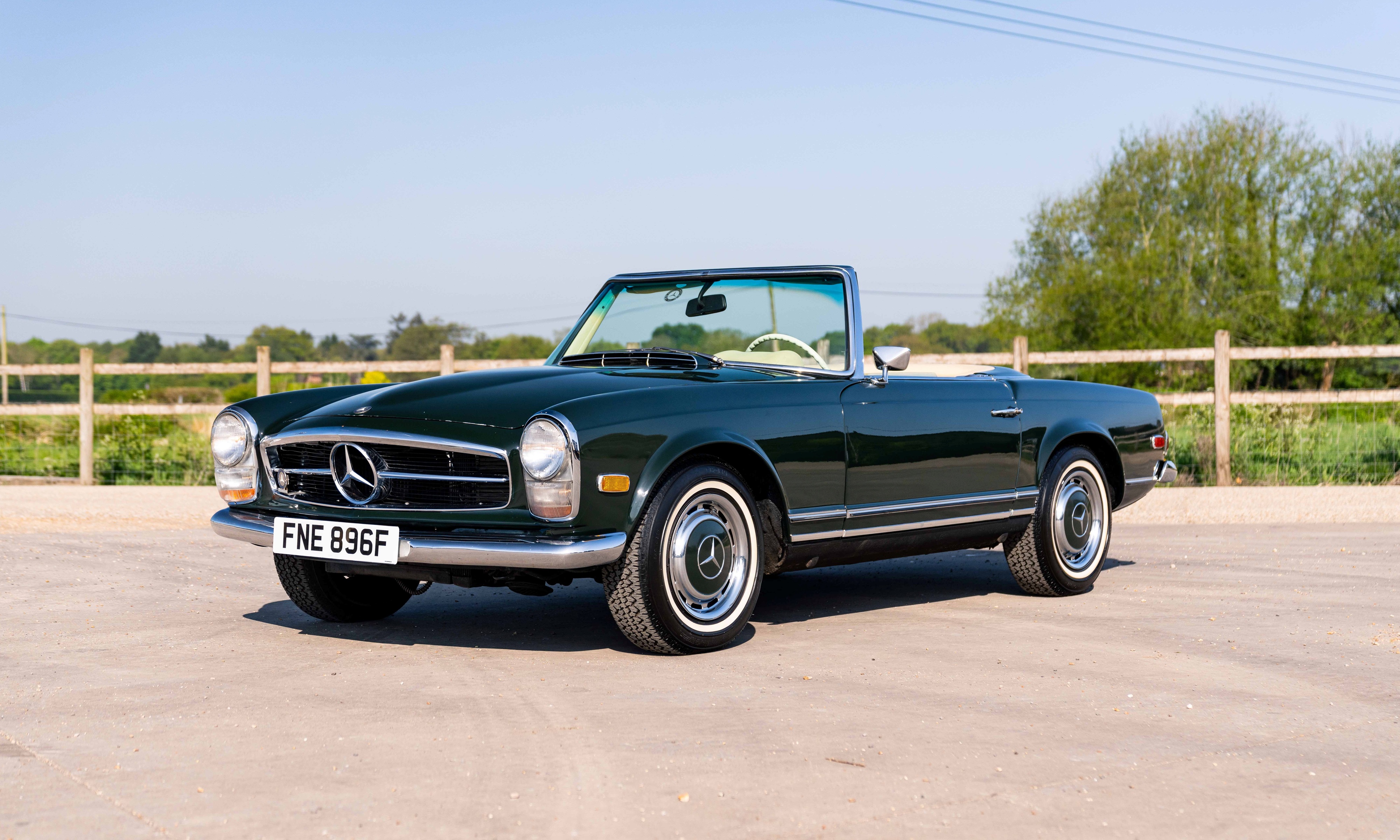

Perfect colour for me. Olive green exterior, cream/white interior:

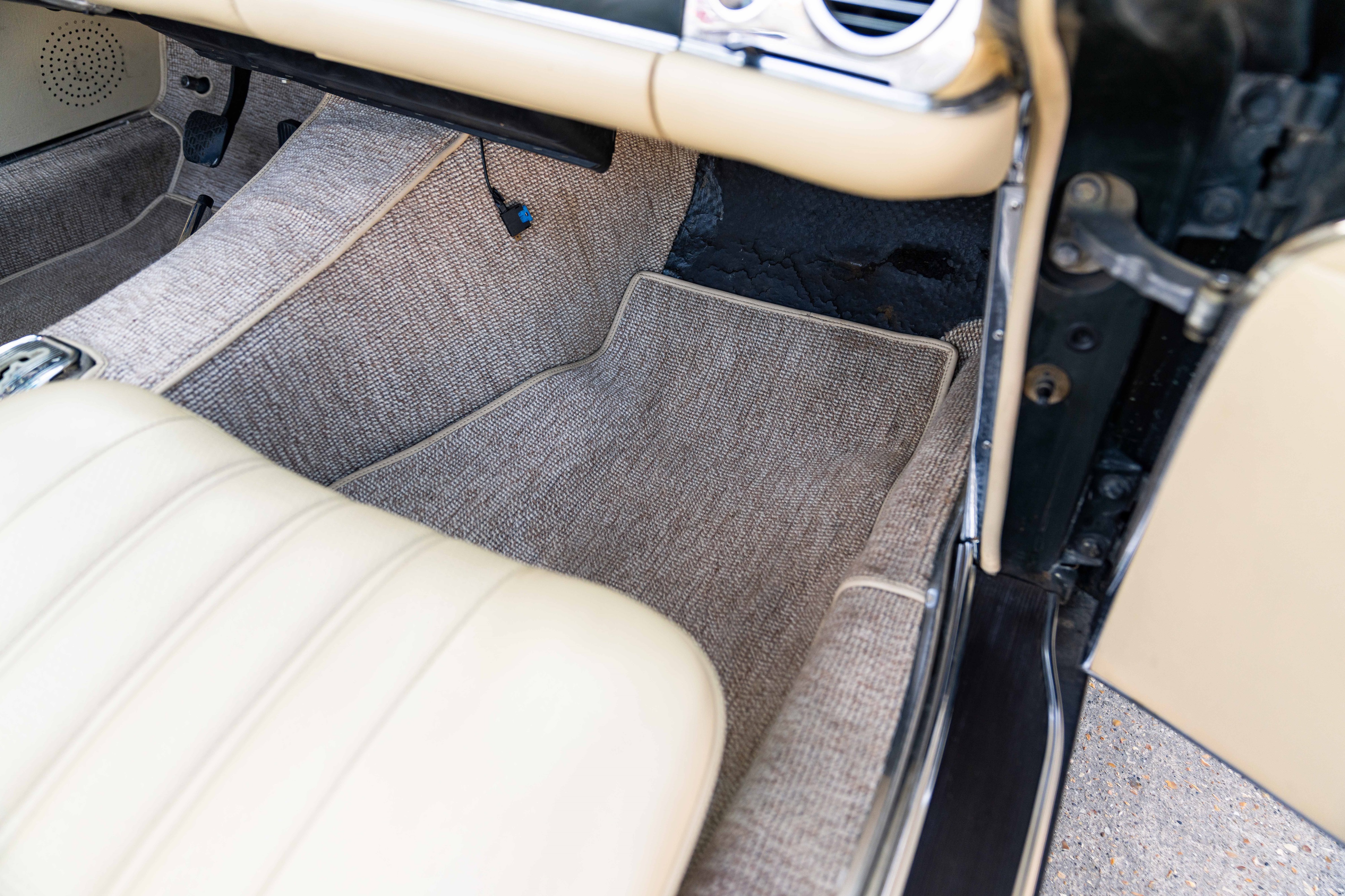

Possible corrosion in the footwells:

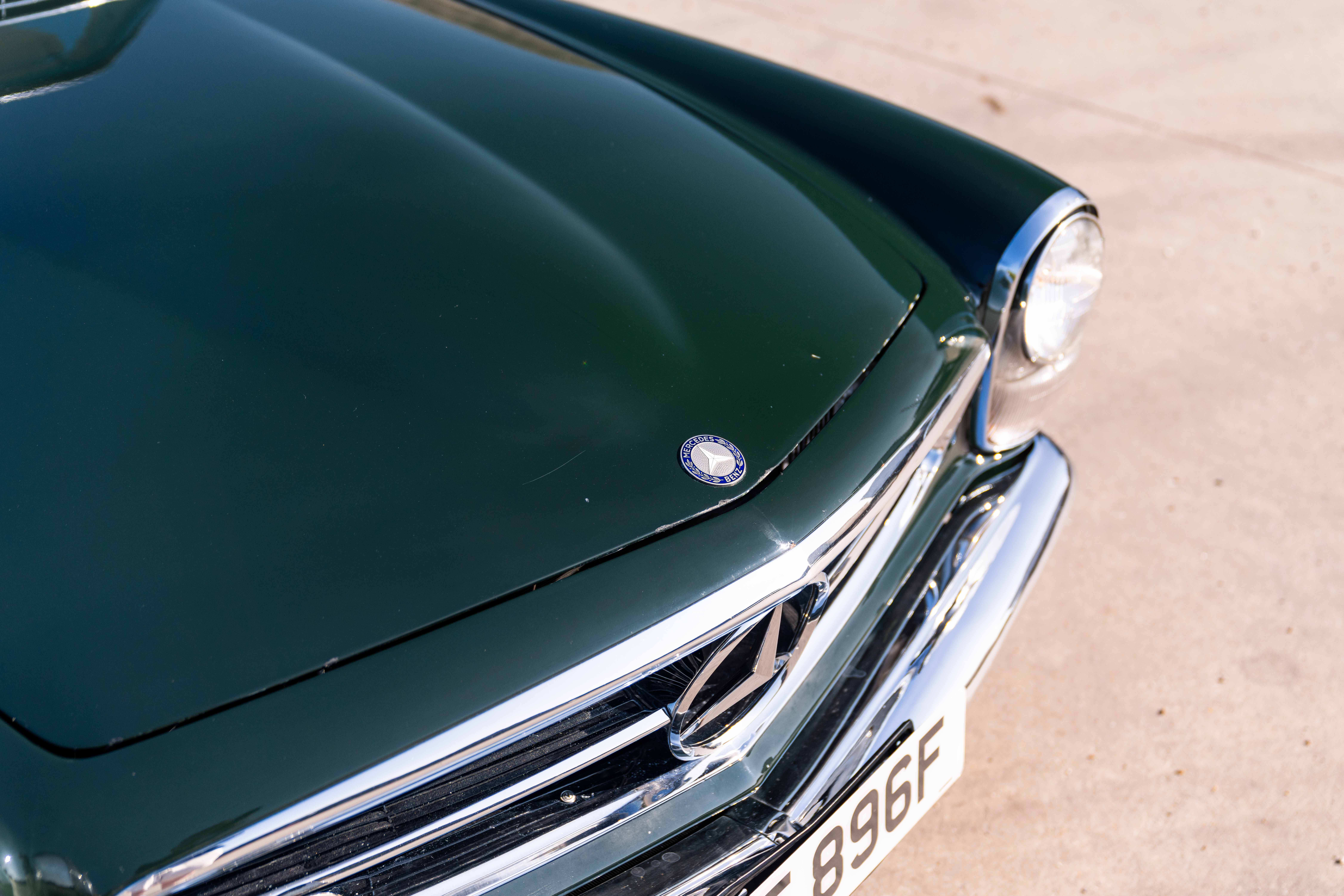

Chipping/bubbling of paint at verious edges:

It's a US spec car that has lived in Italy and is now UK registered. So it's been about a bit and had some restoration work done (the engine bay/firewall pad won't look that good after 50+ years without) so assume the mileage is at least 126,000. And it has no/very little history to tell you what has/has not been done in recent years - Goodwood/Bonhams had a white 230 up this weekend that had had a load spent on a restoration but had much cosmetically wrong with it - which may or may not have been the same underneath
It looks like the engine bay itself is black but that may be the dark olive - which is a lovely colour.
Needs a new soft-top at some point but that sort of depends on how much you may use that. Carpet looks new, indeed, cosmetically it looks v good
If it's close to reserve, it looks like a decent car for the money - with the caveat that there's no shots under the car, no idea what's under the boot/trunk carpet, no idea what the rust situation is or the condition of the engine.

I think it is not a bad car - certainly looks good.
Old soft top, but it is not a very expensive operation. You just need to do it right, but here on the Forum you have all you need for that.
I wonder why there is no correct hood (bonnet) support. I would also see if she is not overheating - as discussed here on the Forum, hood (bonnet) insulation was not recommended as it disturbs heat exchange in engine bay. Checking oil and coolant condition would not be a bad idea due to that, but maybe I am too cautious.
As mentioned already the first and foremost questions are:
1. Rust (and do not be deceived by nice look of the car). It may not be 100% rust free, but the question is how much rust and where is there.
2. Overall engine condition (hence compression check)
If rust is moderate and engine ok more or less - good offer, I think.

Re: What do you think of this 280 SL on auction?
« Reply #4 on: September 15, 2025, 17:34:03 »
Maybe one of our members in the UK can recommend a person or company to do an inspection for you.  No undercarriage pics.   :-\
- These cars never came with a hood pad.
- Where is the correct hood prop and strap?
- What is that box with a relay(?) between the battery and brake fluid reservoir?
- What is that cable or wire hanging from under the dash by the transmission tunnel?
- Is that large badge next to the license plate screwed into the sheet metal?
- Carpet in trunk is not original, nor does it match the interior, but fits nice.
- Passenger window crank is missing upholstery insert.
Rust is #1 issue to know about.  That is best analyzed in person.
