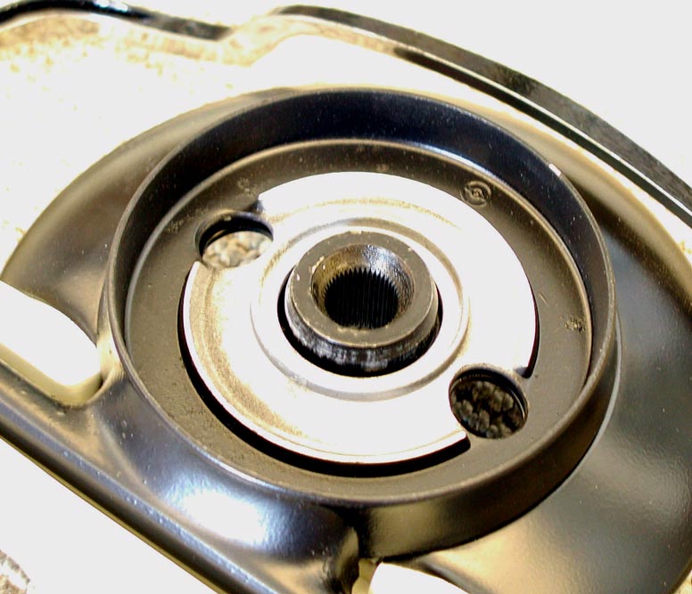

In fact, the steering wheel (ring) is the same. The difference is just in the "signalringnabe", the part where the chrome ring is fixed with screws. And this part is the same for both black and ivory steering wheels.
According to my W113 Spare Parts list, the change was made (as Cees found in his Engelen's book  ;) ) in the 230 SL no. 10275
Please find attached two pictures, showing this difference: "SW-230early.jpg" is the version with the protruding rings (up to 10274), and "SW-230late.jpg" the version without these protruding rings (from 10275).
Cheers!
