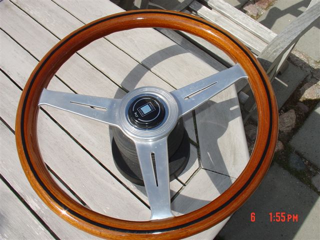

We wish to install our Nardi 36 cm diameter in our Pagoda. The car is born with non-power steering and we are a bit scared that the steering are getting too heavy during parking etc. with the smaller steering wheel. As I would like my wife to get more interested in driving the Pagoda, we are considering either to install power steering or to exchange our 36 cm Nardi with a similar measuring 40 or 42 cm. But the question is if it's worth the time and effort involved?
Your experience and opinion is much appreciated, and if you know of anybody who has 2nd hand power steering components for sale - or wish to exchange a larger Nardi wooden steering wheel for our 36 cm Nardi, we would love to hear from you. See attached photo.

Finn ... I installed a Nardi wheel on my 230SL (manual steering) and did not like it.  The force needed to turn the wheel was not excessive but the steering wheel felt "to closer" and interfered with seeing the gauges.  It just didn't "feel right".  Other people like them so it is a matter of taste.

Thank you very much for your advise. I may stick to the original wheel, as my 36 cm Nardi seems too small. However, the original is white, whereas the interior is black and the vehicle is currently finishing a comprehensive restoration and is going to be silver (was white before). I might change it - and the gear nob - for a set of black instead - my white wheel and nob is in excellent condition without any cracks or damages(see attached photo. If anybody wants to exchange I would like to hear from you!
