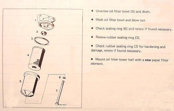

A comment to the oil spill and other grief voiced here, when changing oil inserts on our cars. It must not be that way.
It actually is a neat system on our Pagodas, one must only be sure to change the rubber O-rings. Look at the images
The little O-ring (52) around the bolt (7) must be renewed (after 35 to 40 years in our cars). It then neatly seals and positions central bolt (7), and change of filter insert can be performed spill free.
Let the central bolt (7) sit in the housing (5) during change procedure, just clean inside of housing. Prime the new filter insert with lots of fresh oil, and spin the housing back onto your car. Torque the 17mm hex head bolt (7) to 35Nm (25lb/ft)
Note: Vitally important that rubber ring (2) is fresh, and in its position.
/Hans in Stockholm
/Hans in Stockholm
Missing seal!   Part 2, the 1/2" high seal (cylindrical), has been missing on about half the old MBs(various models) I have bought over the years.  It seals between the housing on the block and the filter in the cannister.  If this seal is missing, the oil bypasses the filter.  Ergo, no filtration.   50% chance yours is missing.  It used to come with a new filter from MB.  No more.
