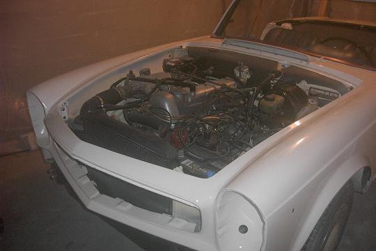

My 230Sl Euro 5 Speed painted with PPG DCC Concept Single Stage Acrylic Urethane in DB050. Now that i know how to shrink the pictures, I'll be sening quite a few incluidng the pictures of the fuel pump rebuilds

Nice looking ride, George.  I'll post photos of mine when it's done.  I should be getting the car back next week and I am really looking forward to it.
