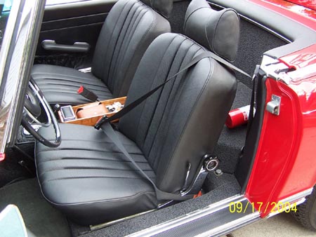

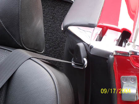

Jim Huber asked for 3-point seat belt photos.  Here are a couple.  Note that the headrest does not factor into the seatbelt issue at all.

I initially got the impression the headrests helped hold the strap in place -- but now realize it only looks that way when there's not a body in place... Am I right that when unstrapped, the belt lays off to the side for the most part?

Actually Jim, when the seat belts are NOT in use, they will retract and become somewhat invisible as the retraction is fairly complete, and the belts just hang in tension, completely vertically, if you so choose.  The only issue of appearance is perhaps the long receptors, which on occasion can actually scratch the wood box.  It isn't too bad though, and a small price to pay.  Some have been bothered by the long receptors, and have fitted shorter ones from goodness knows where.  Others have done their own fitting, but frankly I'm glad mine is in, done and done to the factory tech bulletin.

I put in the inexpensive Wesco Performance ones.  They are black and look just like any other belt.  The receiver/latch ends were too long, which caused the lap belt to ride too high.  So, I took them to a good luggage shop and had them shortened by half and re-sewn with the same pattern as the original.  The Wescos cam with plastic guides to hold the receiver upright.  I was able to cut those as well.  The length of the receiver is now just right and doesn't scratch the center box.  I used the hard points the factory provided.  Except for the trip to the luggage shop, it took all of about a half hour to install.  Much safer.
Here are photos of the installation before the shortening procedure.  This is a Coupe, so the shoulder attaching point is slightly different.  There is no top well to conceal the back strap in.  The covered retractor is exposed in the footwell of the 2+2 arrangement.  I don't have photos of the finished job and the car is still in the paint shop until next week.
