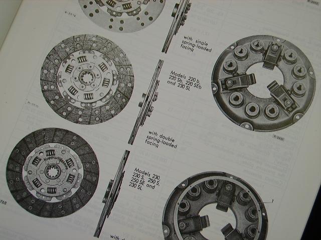

I am sure you will get good advice from the real mechanics on the board, but my word of caution having rebuilt the clutch on a '64 230sl: there are 3 versions of the driven plate and 2 versions of the pressure plate for the 230sl, just make sure to have the right ones supplied for the repair.  Here is a pic from the BBB:
Good luck,
g

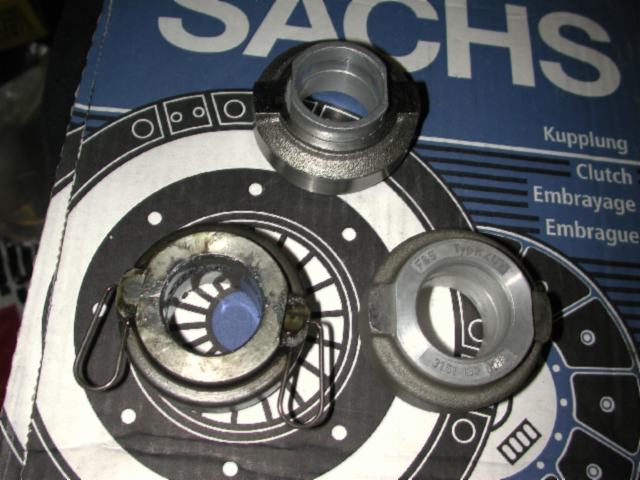

Part #s may help:
Pressure Plate MB: 000 250 9604, Sachs:1882 217 131
Cultch Plate MB: 010 250 2603, Sachs 1861 515 336
Release Brg MB: 000 250 5115, Sachs 3151 133 331
Sachs have now rationalised the same clutch plate and pressure plate to fit all models of the Pagoda.
Unsure which release bearing goes in the 230/early 250
Download Attachment: Gb01.JPG
52 KB
Lower left brg with 2 clips came off the 280SL.
Lower right one is listed for the 230/early 250SL but it does not have the 2 small drilled holes for the 2 clips.
Would be interested to see what comes out of Arjun's car.
Anybody else have experience with these clutches?

naj .... My 230SL throwout bearing had the wire clips.  As I also recall, I pressed off the bearing from a carrier to replace it.
Jim Villers

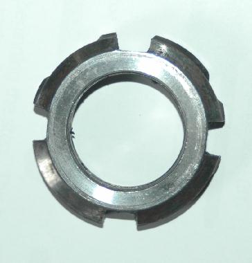

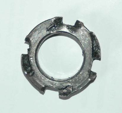

At Aashish' request, here are two photos of the part that fell off:
Download Attachment: Pic1.jpg
59.73 KB
Download Attachment: Pic2.jpg
61 KB
Re: Member in distress, breakdown, help needed!
« Reply #23 on: August 08, 2005, 05:56:06 »
You can see that it had been serviced by the punch marks. That will do in a pinch, but the pin wrench socket and a torque wrench are the better way to go.
 ..and a new lock ring , if possible.
