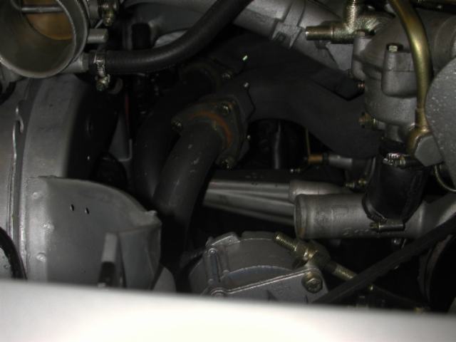

Ben,
Does this picture help at all?
Download Attachment: DSCN0285_edited.JPG
38.85 KB
The heater and rad hoses go on the w/p rear housing. The banjo bolt goes on the t/stat housing with sealing washers either side.

Thanks Naj,
   Unfortunately the picture doesn't really help as I have it stripped to that level but I havent removed the bolt again yet for fear !
However if you state there should be a washer, it seems likely to me, on each side of the fitting then I think I may have missed one upon reassembley and hence have a new leak, despite fixing the original one !!
Do you know what the arrangement between the hgousing and the block is ? If the banjo bolt goes into the housing, arte the threads in the housing...........the more I think about it the more I have confused myself...........a little more stripping is required here I think !
