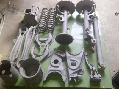

A few years ago I cleaned up some of the undercarriage parts from rust and the result wasn't exactly as I hoped it would be.
That corrosion has eaten away the surfaces and my plan now is to re-sand them down again, itch-prime and have the surface filled with a bondo product which contains a high concentration of aluminum. Sand them to a smooth finish and finish them with two coats of the epoxy primer (PPG DP90?).
Question remains, should I clear coat them or not afterwards?

  • Posts: 4892
Re: SilverSpear's Early 67 Euro 250SL Restoration
« Reply #6 on: March 17, 2024, 22:31:09 »
If you use the attachment feature then we can zoom in on your pics and see them full size.  You're limited to 4 attachments per post, and you can't attach huge files, but it lets us see more detail and ensures the content will always stay on the forum.

« Reply #7 on: March 18, 2024, 01:46:29 »
[/quote]
I would finish them in some of the more durable chassis paints that will be less susceptible to chips and could be more moisture resistant. I believe others on this forum have just used epoxy primer though.

SilverSpear
  • Abu Dhabi, UAE
  • Posts: 238
« Reply #8 on: March 18, 2024, 03:56:29 »
Like what John? Powdercoating?
« Reply #10 on: March 18, 2024, 22:40:06 »
I would powdercoat after sandblasting, most of those under-car parts. For the others I would use a 2K chassis black product, ….
I did exactly what Cees has suggested including powder coating those parts that could be and using the Eastwood paints on other parts that could not be.  The results were very rewarding.  My experience was that the Eastwood coatings took some time to dry and cure but once they did they produced extremely durable finishes.
« Reply #11 on: March 19, 2024, 15:38:47 »
I would powdercoat after sandblasting, most of those under-car parts. For the others I would use a 2K chassis black product, sich as this one:
https://www.eastwood.com/ew-2k-ceramic-aerosol-chassis-black-gloss.html?gad_source=1&gclid=CjwKCAjwzN-vBhAkEiwAYiO7oPI1utjw8uabe9wmb0x_BmPCIuYHiwOblGpm-ffpxUCdhetqPBpAwhoCObEQAvD_BwE&wcid=18669317223&wickedid=672906660478&wickedsource=google&wv=4
https://www.eastwood.com/eastwood-2k-ceramic-chassis-black-satin-and-activator.html?gad_source=1&gclid=CjwKCAjwzN-vBhAkEiwAYiO7oD-LbhYmendVLWhmWmSumGEHBu_hn3z0hS2KFrAkDvZ1c0-2Vg0nkxoC2ggQAvD_BwE&wcid=18669317514&wickedid=629946433624&wickedsource=google&wv=4
I would not bother with the metal filler, too much work for only cosmetic effect - perhaps only use it for limited areas.
Good luck with the restoration!
Thank you so much Cees! And yes Eastwood was on my list and I specifically saw this one.
I am also interested in the esthetics and will try to get her back to perfect condition.
For the subframe, control arms, rear diff, bumper supports will probably see about powder coating. Guess I need to aim for black matte with smooth surface. Hope the local shops can provide that surface finish. Image below
The springs I assume need to be painted with the 2K Eastwood. But I think I have a NOS set though stashed somewhere. That should be enough for my project.
As I was thinking about removing the rust where sandblasting won't reach, I also thought about acid dipping and hot oxiding to prevent rust. And then what is known as galvanizing before powdercoating. Will see what I will deal with in terms of cost.
For the undercarriage, I will be shooting for the raptor liner. There is also a supplier for it locally. Check the forum here: https://www.sl113.org/forums/index.php?topic=32700.msg237981#msg237981
« Reply #12 on: March 19, 2024, 21:49:50 »
You may be ok with powder coating in your climate but I find that where I live on the wet coast of Canada, powder coating is more hassle than its worth for suspension and under carriage if you drive on gravel.
If you get a rock chip on the powder coat, moisture may get beneath and rust may form bubbling off the powder coating.   I prefer sandblasting and then using a good quality 2k paint from Eastwood or other commercial firms.
Be careful with the paint fumes with any of these paints - use a proper mask and ventilation

« Reply #13 on: March 20, 2024, 02:07:01 »
I second Ian’s com concerns about powder coating. I didn’t find it to be that durable from chipping.
