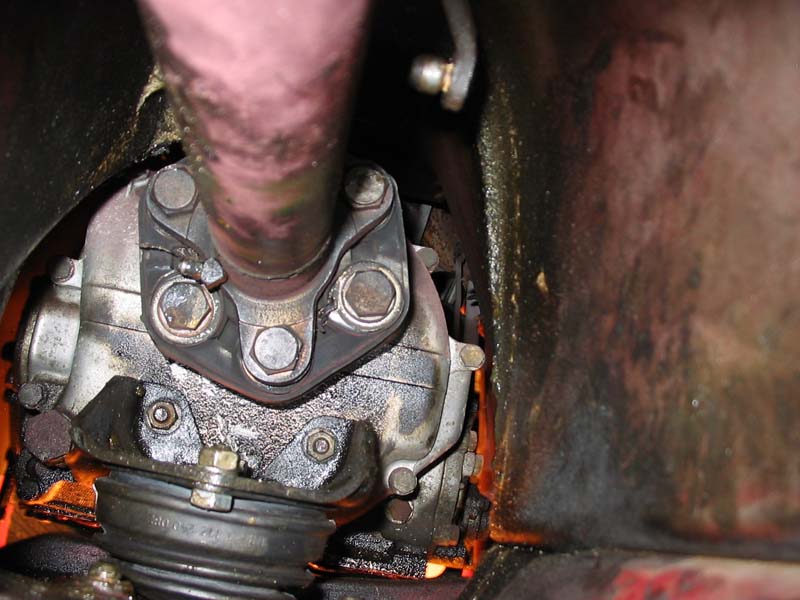

Here is a picture of what I've got. This picture is taken, from underneath the car, near the rear, looking forward. Looking at the rear of the transmission through the drive shaft access hole. You can see the shift rod lever in the top center of the picture, just to the right (passenger side, US model) of the drive shaft. You can see the transmission mount bottom left of the picture.

Somehow, the rod needs to get from the shifter rod connector, around that drive shaft, left of the transmission mount, and down through to the transmission gear selector. I just can't seem to figure it out.
Can you help?  Any chance someone has a car on a lift - and can take a picture? I really need help with this one - I just can't seem to figure it out!

I think you have the gear selector mounted in reverse inside the car. The park position is towards the driver. The sketch shows the stud the other way around with the link rod on the RHS of the gear selector lever.
Also clean around the stud on the lever. It looks like there is some of the old bush still there and if so, it will prevent the new bush from clipping on.
The back of the stud should have a taper like the front.

Oh mny gosh!   I feel like such a dummy.  The shift cover plate must have gotten rotated 180 degrees between taking it off and attempting to replace it. Well that explains that.  I fell like uch a dummy.  I'm not usually this dense. Thank you, Bob - for your reply! I'll get to it tonight ( I hope ).
