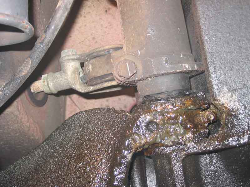

In my repair nightmare this weekend, I was attempting to lubricate all grease fittings on the chassis and drive train. When I got to the rear axle I found a seal on a cylindrical "thing-a-ma-jig" that is mounted on the front right side of the differential case. Looking in the BBB, it *LOOKS* like this thing is called "Carrier for rear axle suspension". Here's a picture, taken from the ground, looking up at the bottom of the rear axle/differential assembly, with my feet out the rear of the car. The top of the picture faces toward the front of the car.
Question: what the heck is this thing?
Download Attachment: IMG0512.jpg
81.5 KB
Download Attachment: IMG0511.jpg
61.92 KB
Question: the rubber seal between this cylindrical thing, and the differential seems to be torn up. Do I care about this?  Is it easy/difficult to replace?
...I know, I know, the whole rear axle assembly is nasty with lubricant drippage/seepage.  One thing at a time, I'll get to it! Maybe this seal is my problem?

Hello again William,
The good news is that most of the rubber bushing is up inside the metal tube, and is probably in decent shape. Oil and grease will attack the exposed rubber over time, so the exposed parts of the bushing deteriorate first. However this is a wake up call and the job will be required in the future. It is a pain.

The problem starts at the pinion seal .. The lube eats the rubber inside the hanger mount. One would think that these have plenty of rubber mass inside , but the originals do not . They are a 2 piece  rubber and are full only on the outer ends .  The center is hollow. The replacement mount has been modified and has the full rubber , so it is that one that is not of concern. One will note that that this is not just a pivot hanger , but also a flex joint for axle pivot/swing. Tne outer and inner points are fixed and the mount flexs with axle swings , making it a working suspension part.
[ For easier expalnation,you can see this in any cross section view]
 An easy quick glance observation on these is to see if the pivot pin bolt eyeballs center with the outer casing of the mount .. if it looks shifted , it is getting bad.. it is always the front section that goes from the leaking seal and drive-line torque.
 The time to change it is when you are doing the seal, as it is not a bad job after the front flange is removed [ which has to be done when doing seal.]
This is done with diff in the car . The pivot pin does
not have to be removed, as the mount will slide off the pin once the pivot pin cinch bolt is loosened and the front bearing/seal plate is taken off the diff.  The seal can then be changed when this piece is off [just easier]
 The main concern on this jub is to either index the flange , nut, and components for re-installing the pinion flange nut, or use the recommended torque measures in the book for pinion bearing pre-load.
 You do not want to over-tighten the pinion flange nut at all cost, cuz if you do, you have to replace the crush sleeve and start all over again.
 I did a section on this in the archieves and should be somewhere in there.. maybe  using 'rear diff change' or such for a search...
I will try and find it ..
 I think it was when Wagas was doing a diff changeout..???

I think both Joe and Arthur are saying the rubber part that is shredding is the rear end of part no. 5 (rubber mount) in Figure 35-5/5.  It runs all the way through part no. 6. The BBB shows this rubber mount as being two parts, but if I've followed the discussion correctly, this was updated to a full length one-piece mount at some point.  It's the rear of this rubber mount that seems to be shredding, just in front of part 8a.
Part 9a in Figure 35-5/3 is the same as part 9 (rubber ring) in Fig. 35-5/5, you should be able to see these rubber rings more easily after cleaning off the grease.  I think I can make one out in one of your photos.

 This is the mount . It slides over the pivot pin and is held to the hanger by 2 cinch bolts. It has an inner casing and an outer casing . Between the casings it is filled with rubber. The new part is the same dimensions as the orig, it is just that the origianal was not rubber filled all the way through..just on each end... so they wore out when oil from a leaking pinion seal eats the rubber..

I couldn't help but chime in here. I recently completed a full axle replacement (my differential was shot), and I replaced practically all the rubber components, including this mount. A.Dalton is right-- you can replace the mount with the differential installed. Referring back to A.Dalton's link (http://213.239.220.84/bin/dbframes.phtml?mid=IN02) and clicking on the picture with the axle:
(1) Disconnect the drive-shaft from the differential flange
(2) Mark the flange and grooved-nut before unscrewing (you need a special tool for uncrewing this-- will post later). Parts #14, #13 in figure.
(3) Remove the front plate from the differential (6 bolts and one cinch bolt).
(4) The pinion seal is part #8, and it mounts into the just-removed front plate (grayed-out in figure, to the right of part #8)
(5) The "shredded" mount is #151. In order to remove this, you need to slide it off the long pin/bolt (#152), and through the carrier (grayed-out, underneath trunk mount #140 in figure). Sliding the mount out while under the car may take some ingenuity, but it is certainly straightforward.
(6) When re-installing the mount and the tightening the cinch bolts on the carrier, it is imperative to make sure the carrier and the left axle are perpendicular to each other. Again, doing this under the car may be a bit tricky.
(7) This might also be a good time to replace the trunk mount itself (#140) if necessary, and perhaps the lateral rod mounts (#114,2x, and #115,2x).
(8) Re-install the differential front plate, flange, and tighten the grooved-nut according to the original settings (or re-torque the crush bearing setting according to the BBB instructions).

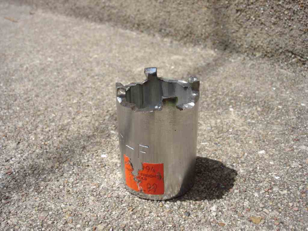

I have strict rules against paying $70 for tools I can easily make (it's in my charter):
1" socket open stock: $2.99
cheapo angle grinder: $8.99
5-pack grinding wheels: $4.99
harbor freight patronage: free
bench vice mounted on plank of wood: (doesn't everyone have one??)
making my own pin-socket-tool-thingy: about 20mins
total: $17 and some care

Here's my pin socket (the original 1" socket is 3/4" drive, so you might need a socket adapter to fit your torque wrench)
Download Attachment: differential-pin-socket.jpg
67.51 KB
Differential Flange Grooved Nut:
Outer diameter:  35mm
Inner diameter: 24.7mm
'Pin' width: 7.8mm
Transmission Flange Grooved Nut (for your reference):
Outer diameter: 38.8mm
Inner diameter: 33mm
'Pin' width: 5.5mm
It's a bit funny to see the dimensions given to one decimal place, given the 'imperfections' in grinding out the pins. The important thing is that the pins fit the nut, and don't slip out while you're trying to turn the socket.
Waqas in Austin, Texas

Waqas .... A very functional pin wrench.  If you use a hacksaw or a cutoff wheel with a drumal tool, you can get flat sides on the "pins".  I have made a number of similar tools and agree with you, why pay for something you can make in less than an hour froma surplus socket.

Wow - that's cool!  I never even would have considered it.  I've got the dremmel tool, but not an angle grinder. I'll look into it. Thanx!   ...totally cool!
