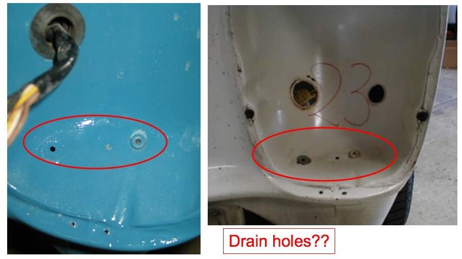

« Reply #14 on: January 11, 2007, 23:11:41 »
Originally posted by rwmastelI found more drain holes this summer and forgot to write about them.  When I had the headlights out I found holes at the bottom of the headlight buckets.  They had rubber grommets.  They look too small for any significant wires to go through, so I assume they are there to drain out any water that gets behind the headlight seals.  Does anyone else have these?
I am reviving this topic since I couldn't find an answer to Rodds question. My 230SL also has these drain holes but some seem to be open and others closed with a grommet and it appears that Ed Cave's 280SL also had them (see picture: 230SL left, 280SL right).
Should all three holes be closed with a solid plug, or with a gromet that allowas some drainage or air exchange? Who has the answers?  :?:

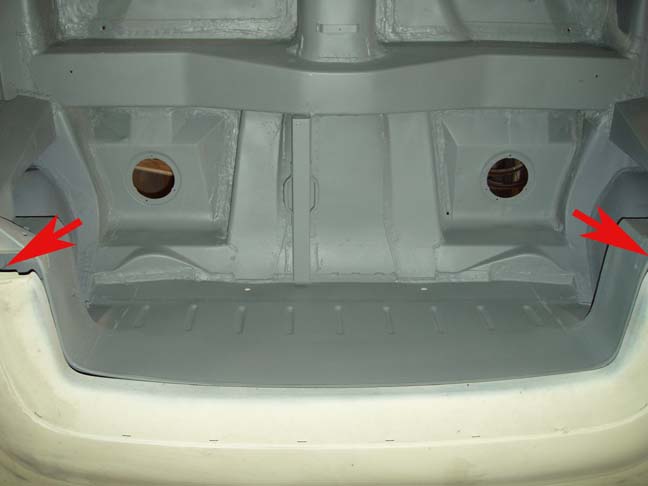

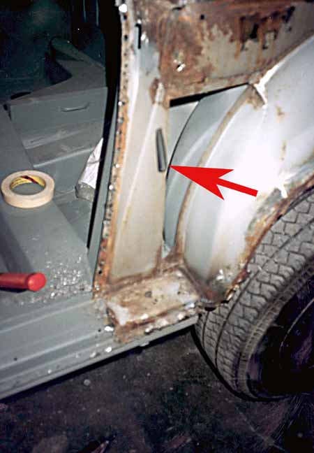

Re: Water Drain holes & leaks ?
« Reply #15 on: January 12, 2007, 02:43:35 »
Here are 2 pics of the drainholes in the softtop compartiment I downloaded myself a while back
Download Attachment: waterdrain 1.jpg
53.82 KB
Download Attachment: waterdrain 2.jpg
32.46 KB
