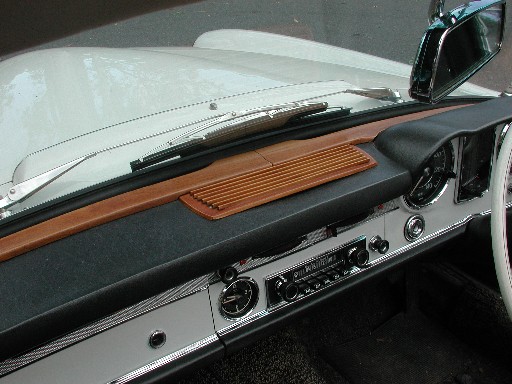

« Reply #5 on: July 14, 2005, 22:32:03 »
My wood trim around the hard top rear window seemed to be the original color which was very dark and matt finish.  I opted for a little lighter stain finish

Vince Canepa
Re: Dash wood refinishing
« Reply #7 on: July 15, 2005, 05:32:33 »
Some say there were several finishes, but I have never seen that option on any order sheets.  Maybe some cars shown at auto shows were finished different.  Some confusion comes from factory brochures of the era, when color printing techniques often distorted colors.
The original finish was a medium mahogany brown, slightly darker than Dick M's picture, and matte.  It was a lacquer with the stain mixed in, i.e. the stain/lacquer mix was sprayed on.  It was almost like paint, as opposed to staining the wood and then finishing it with clear topcoats.  The grain was hard to see.  Almost nobody does it the factory way when refinishing the wood, because frankly, it looked pretty crappy from the factory.  Only the expensive sedans and coupes of the era had the beautiful clear lacquer over stained wood finish.

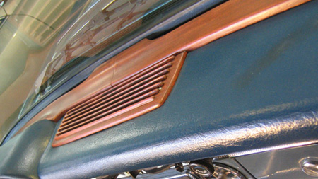

« Reply #10 on: July 16, 2005, 01:26:10 »
Hey Ben
All the wood in my car looks as in the attached picture.

« Reply #11 on: July 16, 2005, 07:04:59 »
Thanks for all the pictures, they really will help me.
