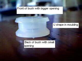

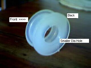

The trans arm bushes are made of moulded nylon. There is a hole all the way through but it is smaller diameter opening on the back end that touches the lever. It fits firmly over a stud that has been machined with a conical taper on the back end near the  selector lever.
The smaller opening is a press fit over that taper.
The outside of the bush has a "U" shape moulded into it.
The bush is fitted to the linking arm then the arm is fitted to the selector lever.
There is no need for C clips.
Part number 112 268 01 50 they were $19.20 each in Australia.
I have attached a couple of pics so that you know what to expect.
Download Attachment: GearLeverBushATrans_1TEXT.JPG
13.1 KB
Download Attachment: GearLeverBushATrans_3TEXT.JPG
9.88 KB

Blair, the bushes are definitely fitted to the link rod first.
Soak them in HOT water to soften then, use a vice or something similar to press them in.
Remember they work only one way. You will understand when you get the new bushes and have a look at the selector lever on the trans.
Make sure you are supplied with the correct bushes. I wasn't and the lever came off within about 20 meters of driving.
