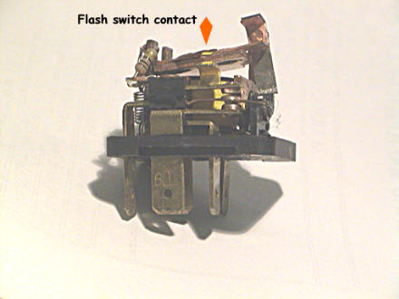

The relay has a separate pair of momentary contacts for the flash to pass feature.  I hope the pic helps explain.  A little lower and to the right in the pic you will see the latching switch contacts.
Download Attachment: flash relay1.jpg
