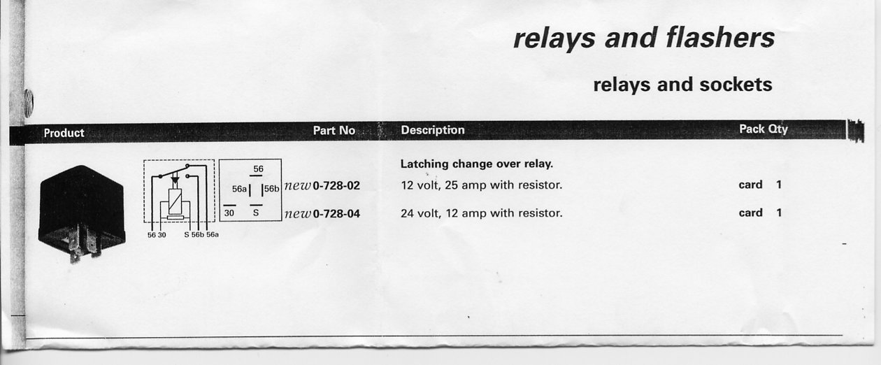

Here's a schematic.
Hope its legible.
Download Attachment: LatchRelay.jpg

The schematic looks good.  As the solenoid is energized by pin S and 30 the main switch toggles between 56a and 56b.   The VW relay schematic has a second switch fed by pin 30.  As the solenoid is energized this second switch closes to conect pin 30 to 56a. This switch enables the flash function for high beams.  30 is hot from the stalk even when the light switch power to 56 is off.  This way the flash function will work when the headlight switch is off.
That is the Ticket... I don't want to loose that feature ..
 Is that just an extra contactor set actuated by the same coil??  Must be.

« Reply #18 on: July 19, 2005, 16:47:23 »
It is activated by the same coil.  VW Part No.: 111 941 583
Meyle cross references this part number to Meyle No.: 100 941 0006
This relay is used on a bunch of Audi and VW cars.  I'll scan the schematic and send it to you Arthur.  I can't post pics here.

JeffC / A Dalton,
That will work..
Hmmmm, slight problem:
When high beam is on, 56a (high beam feed) will also energise terminal 30 on the relay - hence no more switching  :( .
Jeff, I believe you already experienced this with your mock-up???
Fix:
1. Use stalk only for switching hi/lo beams and disconnect feed to hi beam for flashing (Also wire 56a in MB wiring diagrams)
2. Use a (zener ??) diode to the flashing hi beam feed to stop it feeding  terminal 30 on new relay.
