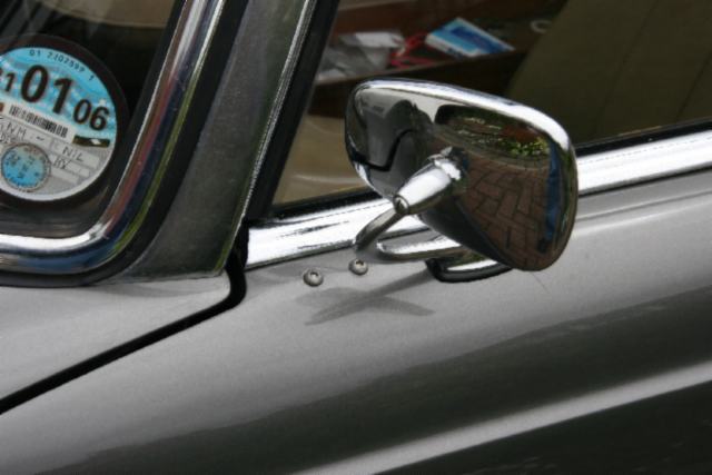

Correct!  For some reason, when reading through the search results I thought I should focus on 280SL mirror issues.  Yes, Ed has a 230SL and that does require the mirror to be mounted further away from the a-pillar than the driver's mirror.  There's a thread on that, even showing what needs cut inside the door.
https://www.sl113.org/forums/index.php?topic=26900
Naj from UK (RIP) had to move his passenger mirror.  Do it right the first time!
https://www.sl113.org/forums/uploaded/naj/200552124024_MirLoc03.JPG

Can't do that with the 230SL goose neck mirror.  Needs to be further to the rear.  See my post above showing Naj's adjustment.

Maybe it's more about seating position?  I don't know, but Naj clearly felt it important to move his back.

Rodd,
That's an interesting thought.  I drive with my seat back against the parcel shelf, so far back.
If I were in a position to take some photos I would, but I can't for at least several days.
          -David
