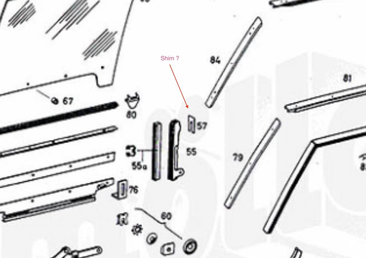

I did spy what might be a a shim on the schematic by the rear channel guide. I haven't discovered any part that looks like it on mine.
It could be missing ?
The top bolt through the door holding the rear channel guide has a washer on the inside but no shim on mine. A shim here could potentially push/tilt the glass more "forward"
I'm attaching the schematic parts diagram to show what might be the "shim" ? #57

That adjustment channel is what I would expect. The fat washer on the bolt is the give away. It is needed to cover the large adjustment hole. I looked up the shim on Mercedes' EPC and is part # 111 725 51 47. They call it an adapter and says .5mm as required. So yes, that is a shim. You may or may not have one depending on need.
To me the door glass adjustment is like setting body panels. You start with the part that has no adjustment and in this case, that would be the A pillar. You would set the vent frame against that for a perfect fit. You can fudge the gap between the A pillar and the frame some, but not much. The important thing is that the gap between is parallel. The qtr window is basically non adjustable. So the glass and guides has to fit between those two. The fit with the qtr glass and door glass has a fair amount of room to fudge because they overlap.
There should also be an adjuster at the bottom of the vent frame channel. should be about the same as the one in the rear.

I think the fuzzies that m330 cab is talking about is the fuzzy channel on the vent frame. Yes, that does come in a roll. These horizontal strips only come in a strip because they are rigid.
The strips I got from MB were thicker than the original. You can try the classic center and see if they have it. The other issue to me was the quality. The fuzzy skin on the MB part was not pinched well into the metal U channel at the bottom. It could come apart easily. Others on this site have stated a similar issue. If they have fixed that now, not sure. The German made unit from Niemöller or MB Classics was far better, but just a bit thinner than the original strip. Using two of the MB strips left too narrow of a gap for my quarter window and I used one of each. You are better off having a larger gap than too narrow of one. If the glass get squeezed in between too tightly, it will bind the motor and eventually peel the fuzzy off of the strip.
