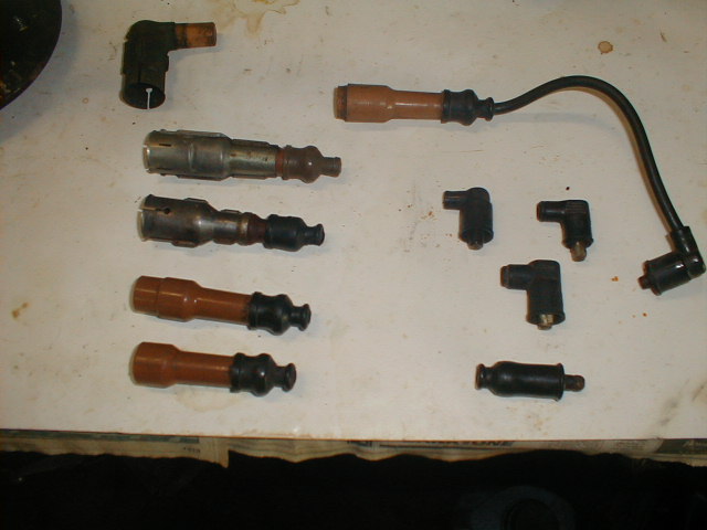

The early 1,000 ohm resistors spark plug ends were #000 159 2189, the later metal shielded ones were 5,000 ohms #000 156 3210. I am not sure when they changed to the 5,000 ohm, possibly with the addition of the factory electronic ignition.
According one service manual, the resistor ends should be replaced when the entire wire assembly reaches 20,000 ohms or more.
Here is a photo of some original spark plug wire ends. Yes the right angle one is for a carbureted engine.
Download Attachment: spark plug wires.JPG
54.9 KB
« Last Edit: July 04, 2005, 07:36:33 by ja17 »

Bakelite ends for 230SL
Same ends with metal covers for 280SL
13,000K ohms is WAY too much resistance. The black coil is only 13,000 volts - that car probably wouldn't even start.
If you have resistor ends on the coil wire and distributor cap you have 4K right there. Add another 5K for the rotor ( no one EVER mentions the rotor do they ? ) and now you have only 6,000 volts to fire the plugs. Add a carbon wire for good measure and have fun.
I just use the plugs as they come gapped out of the box.
