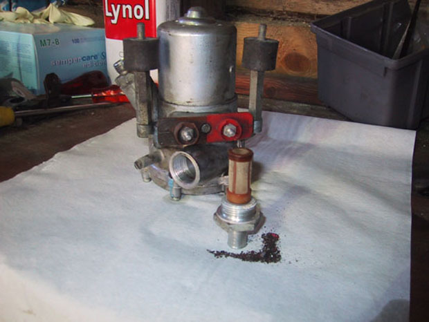

I tried to reverse the polarity on the fuel pump to blow out dirt. I let it run for about 30 seconds. Afterwards – just to be sure – I removed the filter and it still had a lot of dirt in it.
http://www.sl113.org/forums/uploaded/knirk/2005617173851_fuel%20filter.jpg
Hard to say how much more dirt present without the blow-out procedure. ;)
