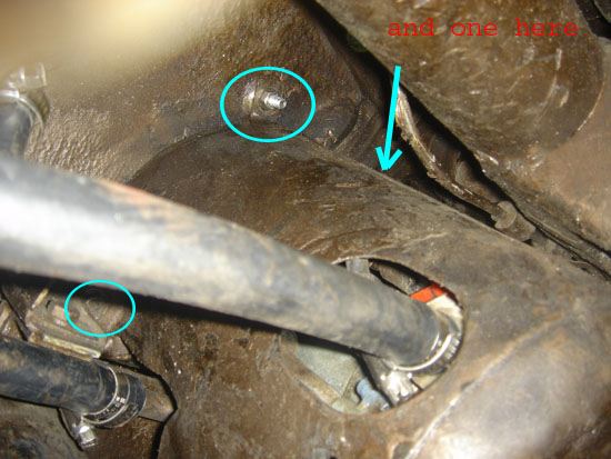

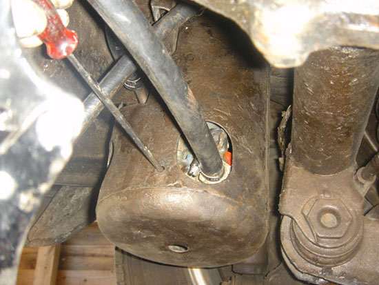

And finally today I cleaned the fuel pump filter. Not much info in the manuals so I took some pictures.
One bolt and two nuts holding the pump shield (10 mm spanner).
Download Attachment: shield.jpg
80.45 KB
I used a clamp on the inlet hose instead of emptying the tank.

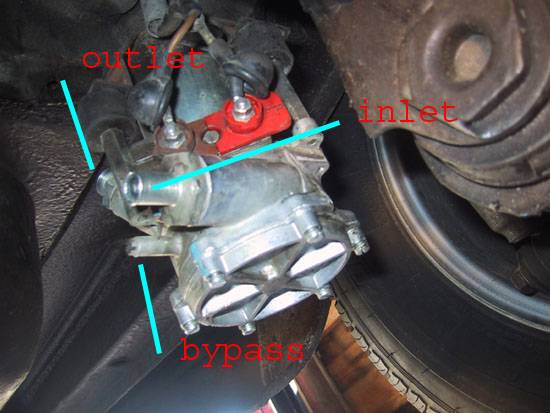

This is the new / small type pump. The fuel outlet connection uses spanners 19 and 22 mm.
Remember were the electrical cables belong.
Download Attachment: pump 1.jpg
77.99 KB

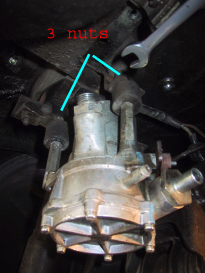

The pump is suspended in three bolts. Unscrew the nuts at the top with a 10 mm spanner.
It may be possible to unscrew the fuel filter without removing the pump, but not mine.
Download Attachment: pump mount.jpg
63.78 KB
The fuel filter sits on the inside of the inlet/nut unit. 24 mm spanner.
This is how much dirt that came out after I tapped it a few times. I also cleaned it with compressed air.
Download Attachment: fuel filter.jpg
68.48 KB

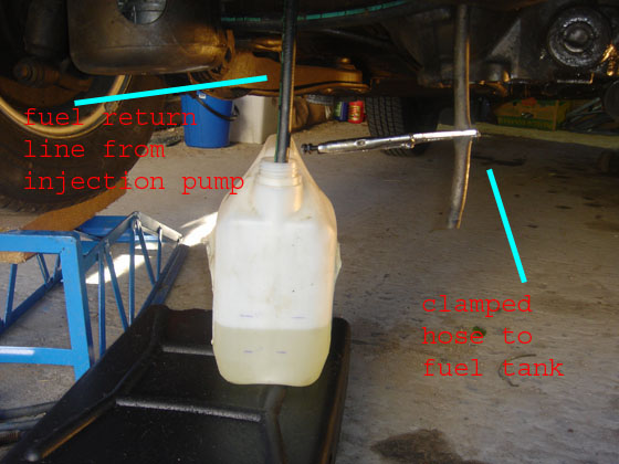

After installation I blead the pump by the little screw in the by-pass connection. According to the Haynes Manual there should have been installed a hose from this connection via a T to the  fuel return hose. I have read somewhere that if not installed you need to bleed the pump with the inserted screw (accessible through a small hole in the shield).
Download Attachment: pump bleed.jpg
79.49 KB
Finnaly I did a new fuel pump flow test and the amount went up from 0.75 to 0.8 litre in 15 sec. I used a hose with a clamp to blend off the fuel tank return inlet. I managed to swap between the hoses while holding my finger over the opening – without much spill.
Download Attachment: fuel.jpg
76.93 KB
I then went for a new test drive. And even if I may still have a slight blockage somewhere or a not so good fuel pump (should be 1 litre in 15 seconds) the engine misfire under heavy load disappeared – and this time I kept on smiling. :D
