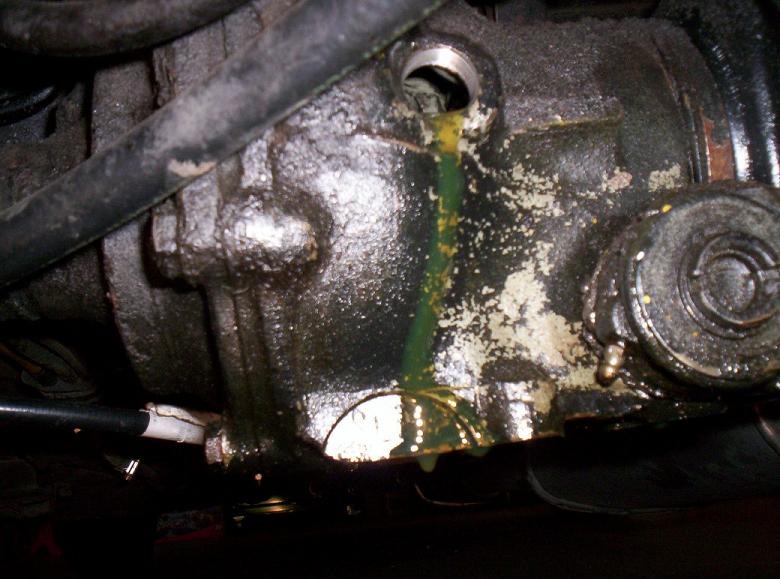

« Reply #13 on: June 19, 2005, 21:50:29 »
Decided to crawl under there and check things further. I began by making my first homemade Pagoda tool to get differential plug out. A variation on Ricardo's. I used an old 9/16 bolt and some vice grips... Thanks R
Download Attachment: tool.jpg
64.97 KB
Once I removed the plug, oil literally streamed out. It was obviously overfilled. It just kept coming...
Download Attachment: overfow.jpg
84.57 KB
In fact, to get to finger-dippin' level, I had to use a rubber tube to siphon a bunch out. I also spotted the vent while I was under there. It was caked with 40 years of crud...
Download Attachment: vent.jpg
63.92 KB
I managed to clean it off and got the cap off. It seemed to be crimped on there but I got it off. And inside was that little filter. Cleaned it as best I could and put it all back together.
I am very curious to see if my differential leaks will slow down after this procedure. I cleaned things up -- and last I checked not a spec of oil... Of course, this may have nothing to do with my mystery high-pitched squeal. But it still was fun getting my hands dirty!
