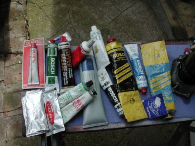

Hmmmm Grease:
Download Attachment: Grease14.JPG
50.21 KB

geeez greeez Naj,
 you could prolly get a G Note for the package on Ebay !!!!!!
