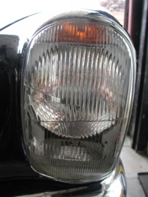

« Reply #14 on: August 03, 2005, 14:03:58 »
Headlamps:
Right Hand Traffic (left hand drive)
Note the '<' shape on the right half of the lens.
Download Attachment: BurghHdLmpRHT.JPG
44.34 KB
Left Hand Traffic (U.K. Australia etc.)
Note the '>' is on the left half
Download Attachment: BurgHdLmpLHT1.JPG
41.85 KB
Note the raised beam on the right end when light shining against a wall (RHT)
Download Attachment: headlamp.jpg
40.18 KB
« Last Edit: August 03, 2005, 14:23:33 by naj »
Re: Euro headlight: Right and Left
« Reply #15 on: August 03, 2005, 16:13:43 »
So Naj, by "'>'" you mean the section where the glass pattern is sort of skewed?
And when you show the left-hand lens for a left hand car, I hope the '>' is also on the right side of the right hand lens. That's how mine are.
  • Posts: 4921
« Reply #16 on: August 03, 2005, 17:37:20 »
Yes, the idea is the light gets cast upward along the side of the road to see road signs.  So, using our short hand, it should look like < < or > >.
« Reply #17 on: August 04, 2005, 03:02:23 »
Not sure what you mean here, Rodd.
For USA, both lights should cast the upward beam to the right (see headlamp adjustment picture).
Casting up to the left would mean blinding oncoming traffic.
James,
Yes, I do mean the small quadrant with one almost horizontal line and the other a few degrees above horizontal.
And yes, both lenses should be the same.
