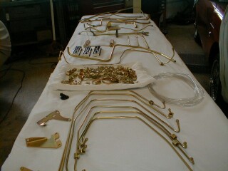

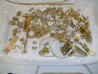

« Reply #7 on: June 06, 2005, 11:21:10 »
Here are two photos, pulled once again from Brian Peters restoration log, that show (but don't list) the numerous parts, fasteners, etc. that he Cad plated for this project. Not sure where you might find a better photo giving you an idea just how many parts in the engine bay were in fact Cadmium II plated.
Sorry the photos aren't larger, you may see the detail better here http://www.motoringinvestments.com/RestoLog4.htm  Click the photo for a larger view. (PS this is the same car that had the "23" in grease pencil in the headlight bucket, recently discussed in a different posting).
Download Attachment: CAD Plated1.jpg
