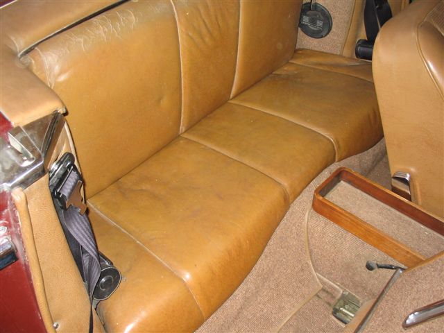

Hey Will
Good to see your name here...you won't remember me but a couple of years back you were very helpful to me with advice, parts and manuals, I'm glad to get a chance to help you a little.
My '67 250SL, originally a topless coupe delivered to Stuttgart, has since had a top added, but I believe the bench seat is the original leather. The rest of my interior was redone but the rear seat appears to me, to be a slightly different color of cognac, shows more wear and the way in which the materials are put together looks untouched. Of course the seat back was altered to fit the top well addition but the back was cut down and the leather restapled.
Hope this helps
Richard Vezeau
Shawville, Quebec
Download Attachment: reduced benchseat.jpg
55.86 KB
