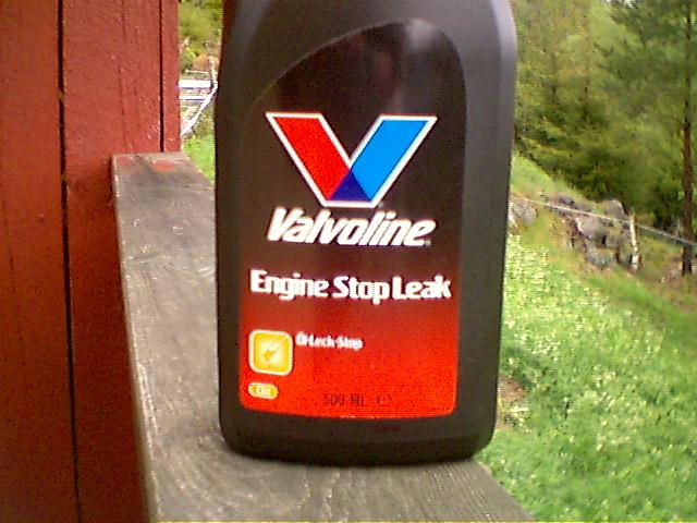

I had my SL to the bi-annual mandatory check up last week, and the only thing the mechanic complained about was an oil leak from the engine. The engine was rebuilt last year and it’s dripping a drop or two now and then – not a big problem. Eager to get the car accepted for another two years on the road I let the guy talk me into buying half a litre of “Engine Stop Leak”. He is an old mechanic and claimed he had used this with great success many times before. The can of oil should be added to a warm engine – sit for 10 minutes with engine at idle, and should stop any leak within 500km.
I am generally reluctant to any additives, but I do feel a little urge to try it. Any comments?

« Reply #12 on: June 02, 2005, 00:54:38 »
I am very interested in learning the result of the “Engine Stop Leak” formula.  I am ready to try some if it works as described.

knirk
Re: Pagoda Oil Leaks
« Reply #13 on: June 02, 2005, 02:19:14 »
Louis,
I havn't tried it yet - hoping for some inputs from anybody else familiar with these kind of products.

« Reply #14 on: June 02, 2005, 03:34:23 »
I used a "Stop Leak" product made by eoither Wynns or Forte. I used it in a 2.9 V6 Granada that had a rear crank leak. It had dripped for a few years but it wasn't worth taking the engine or tranny out just to fix the leak. I tried the Stop Leak and had 100% success. After about a week it stopped completely and never leaked a drop again !
I think it swells the seals slightly so if the seals are in decent condition it'll work. If the seals are original or damaged then obviously you'll still need to replace them !
