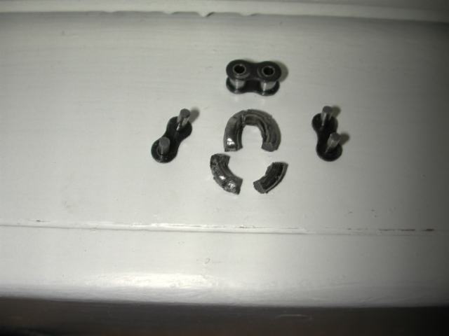

Re: Timing Chain Failure
« Reply #28 on: September 19, 2005, 12:41:29 »
Phew  :|

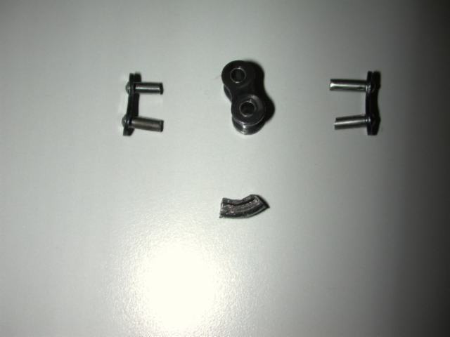

Valve cover is finally off.
Found a bit that looks like a spacer/thrust washer - got between chain and left hand idler. Double chain sheared in half. Couple of teeth broken off idler.
Any thoughts on what the 'bit' might be?
Further stripping continues.
Download Attachment: TmgChn03.JPG
17.94 KB
« Last Edit: September 19, 2005, 12:42:31 by naj »
  • Posts: 7507
« Reply #29 on: September 19, 2005, 20:31:21 »
Hello Naj,
I cannot tell what the foreign part is from the picture. However I can observe that you have an early design "figure eight" style timing chain.
Keep us up to date. Ask questions, we can help!

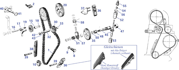

« Reply #30 on: September 20, 2005, 02:49:44 »
Could it be a piece if a guide rail ?
I know the replacement guide rails are plastic, the originals probably are too, so just a thought !
Aren't they plastic over aluminium and could this original chain have worn all the plastic off and picked up a piece of the aluminium ? It certainly looks like it has a groove in it, before it was bent, and it would havce had to be carried by the chain before becoming the "meat" in the sandwich !

« Reply #31 on: September 20, 2005, 05:53:56 »
Hi, Joe,
Question is how to set the inj pump sprocket to get correct timing when installing new chain.
We'll go with your idea of replacing the crank sprocket by removing the oil pan (with hood and rad off)
Hi, Ben,
Early guide rails are aluminum with a lining, but this 'bit' is hardened steel.
Maybe more pieces in the pan will give a clue.
Will keep you posted of the findings,

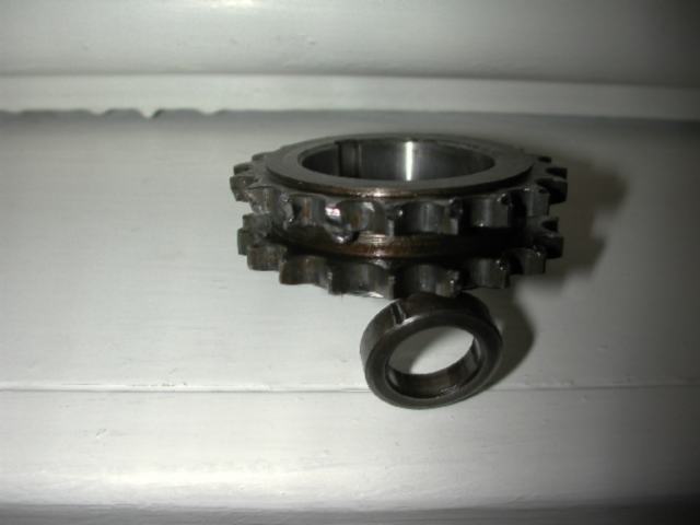

What's this?
Any clues?
Download Attachment: Tim_Gr02.JPG
19.65 KB
Crank sprocket
Download Attachment: Tim_Gr05.JPG
21.68 KB

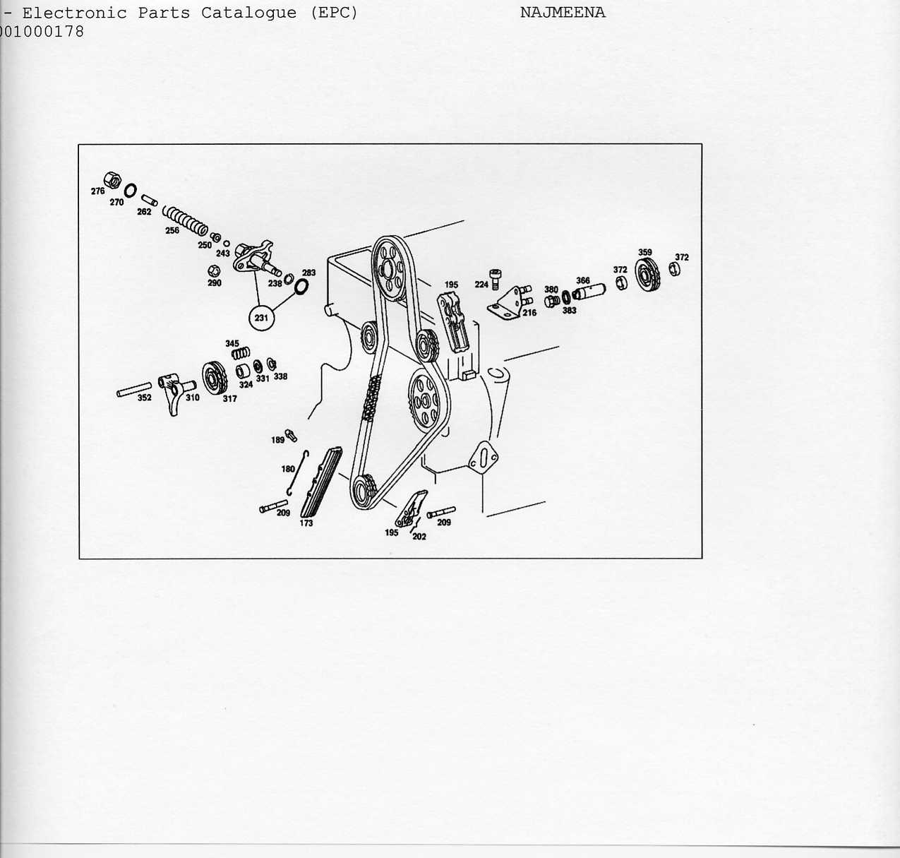

OK simpler question:
#195 TOP timing chain sliding rail next to Mounting Bracket #216 - is it facing the right way or should the extension be facing upwards?
Download Attachment: TimCnh01.jpg
71.1 KB
« Last Edit: November 29, 2005, 13:56:26 by naj »
enochbell
« Reply #40 on: November 29, 2005, 14:33:53 »
It appears correct in the pic, orientation is with extension facing downward.
g
Download Attachment: IN02_0035.jpg
59.56 KB
« Reply #41 on: November 29, 2005, 15:50:31 »
As the chain links pass over  the rails, they enter the heel of the  rail  first.
 Engine is CW viewed from front.

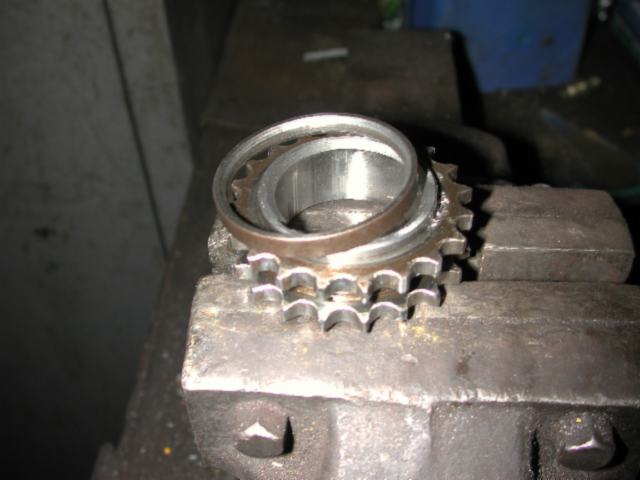

Early crank gears had spacers
Early crank sprocket with spacer:
Download Attachment: Tim_Gr14.JPG
32.98 KB
« Last Edit: November 30, 2005, 14:13:50 by naj »

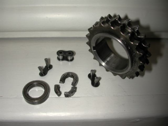

« Reply #45 on: January 18, 2006, 13:56:22 »
Okay, to wrap up this thread, Itm 372, idler gear spacer broke (can't tell why) and got caught up in the chain.
http://www.sl113.org/forums/uploaded/naj/20051129145148_TimCnh01.jpg
Earlier thoughts were that I may have installed the top chain rail the wrong way round allowing the chain to whip about, but some pictures taken after the cyl head change show it correctly installed.
Could I have (inadvertantly of course) dropped  the spacer into the cavity? Do remebber checking but....
If, so, where was it for the last 500/600 miles the engine ran fine before getting caught in the crank sprocket (most damaged).....
Any thoughts  :?: [:0] :oops:  :?

« Reply #46 on: January 19, 2006, 04:08:37 »
........and thats a distinct possibility. It could have sat between the chain and the head somewhere ...............lying there........
waiting...............and then for no reason ...........BANG ![:0]
  • Posts: 7263
« Reply #47 on: January 19, 2006, 11:49:21 »
There's no way that part can break or fall out. It must have fallen out when you pulled the shaft or put it back in. Did you pull the head or have the whole engine out of the car?
Normally, This part can stay in the head and I only remove it for cleaning or inspection. The spacer may have wedged into a chain rail and then finally dropped into the chain and crank gear. Are any of the chain rails damaged or the inside of the block/chain case worn with marks that would indicate where this part was caught? It's definatly a loose part and not on the shaft.

  • Posts: 7263
« Reply #48 on: January 19, 2006, 11:59:51 »
Just had a look at all of these pics. How thick is the broken part? If it's about 5-6 mm it's the spacer. If it's thinner with a chamfer on one side it's not the spacer and is likely a head bolt washer that goes on top of a cam bearing. The hole through the centre is smaller and the whole piece is not as big as a spacer. The chances of a loose washer floating around on top of the head are far more possible and would be consistant with several hundred miles of driving before the big bang........
  1 877 661 6061
« Reply #49 on: January 19, 2006, 13:28:37 »
Hello Dan,
Yes, I swapped to a 250 head about 500/600 miles ago.
It is 5-6mm square section and seems to be the spacer. I have to agree, I could have 'inadvertantly' dropped it. Seems too strong to just break without any cause. Its interesting that they are no longer used on the 129 and 130 engines.
The longer chain rail cracked between pins but could not see any other markings in the chain gap in the block.
The pistons 'hit' two valves and bent the rocker fingers but did not bend the valves. (Joe explained this happened because the piston tops are flat and valves vertical. Luckily, too the cam support bearing posts did not break)
Download Attachment: Tim_Gr04.JPG
24.99 KB
