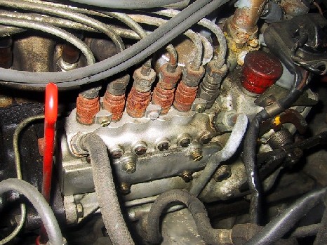

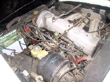

This gentleman wrote me back.  He said the owner is not on a computer very often, that's why he is making the inquiry for him.  Here are two photos he sent me.
Download Attachment: First W113 -1.JPG
77.88 KB
Download Attachment: First W113 -2.JPG
78.51 KB
Of course, you notice the black engine bay right off.  The MFI pump is not a normal 230SL pump.  Was the only other 6-plunger MFI pump up to that point from a 300SL?
I wrote and asked him to look for the VIN on the right front frame rail.  Also, I asked if the MFI pump had an ID plate.

The whole thing looks bogus to me. Look at the dip stick - it's at least 65 or later. Not sure what's so different on the fuel injection pump but then the pictures don't show the back of the pump. There appears t be no mechanical linkage going to the pump which is similar to the 300SL. Those pumps run from a vcuum signal on the throttle housing.
Only cars in '63 that had fuel injection were the 220SEb coupes and sedans, 300SE coupes, and maybe 300d. 220 had 2 element pumps while the rest were 6 element. These systems were all very much different from each other.

Yeah, It looks like an R-8 with Vac. Controller .. but really need to see back of pump...

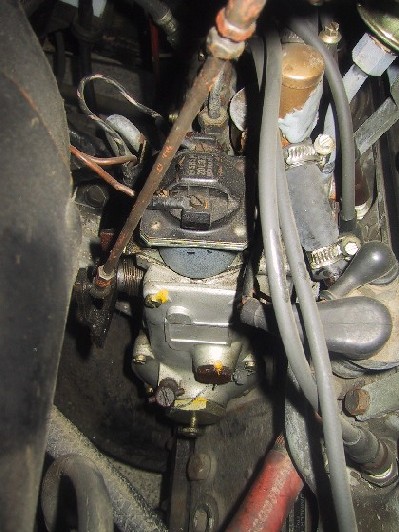

Here's another image he sent me, rear of the pump.

This is clearly something different. It's definatley run by throttle linkage and the pump is set up similar to a 220SE with the start solenoid on the top. The air filter for the auxillary air is on this long pipe and the housing for the temp guage probe is right off a 220SEb. In fact it has a lot of 220SEb parts, so from that stand point it's pretty early.
No way of telling if it's a prototype. I've never seen a VIN number like that before.
