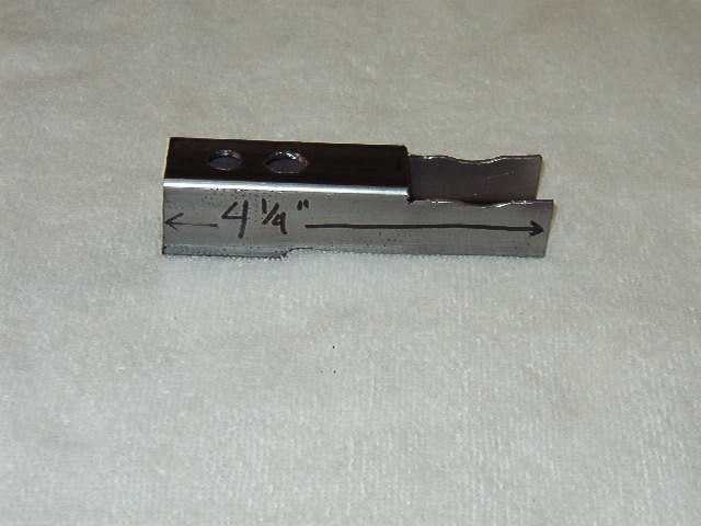

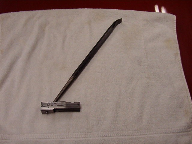

Homemade rocker-removal tool photos:
Download Attachment: RockerTool1.jpg
58.38 KB
Download Attachment: RockerTool2.jpg
64.24 KB
Download Attachment: RockerTool4.jpg
57.35 KB
Download Attachment: RockerTool5.jpg
63.11 KB
I have no luck with the screwdriver trick.  This tool is made from 1 inch x 1 inch square steel tube.  Note two upper holes allow different pry-bar angles to clear brackets.  In use, the tool is slipped under the camshaft from the valve side, the curved sections cup the camshaft and the legs sit on the valve retainer.  Pry the valve down, pop off the rocker.  Watch for the lash cap on top of the valve when reassembling.  Non-gold-plate, will sell for only $250 :)
