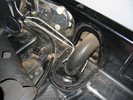

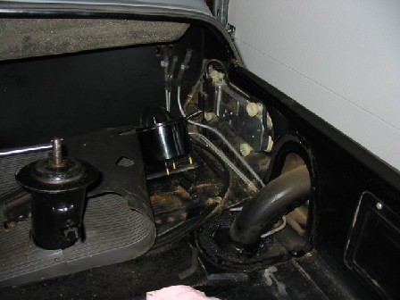

Does this help?
Download Attachment: Copy of Fuel Pressue 1.jpg
37.99 KB
Download Attachment: Copy of Fuel Pressure 5.jpg
52.76 KB
I strongly agree on performing the Search for detialed info.
