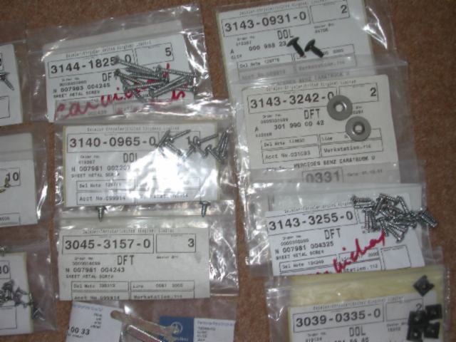

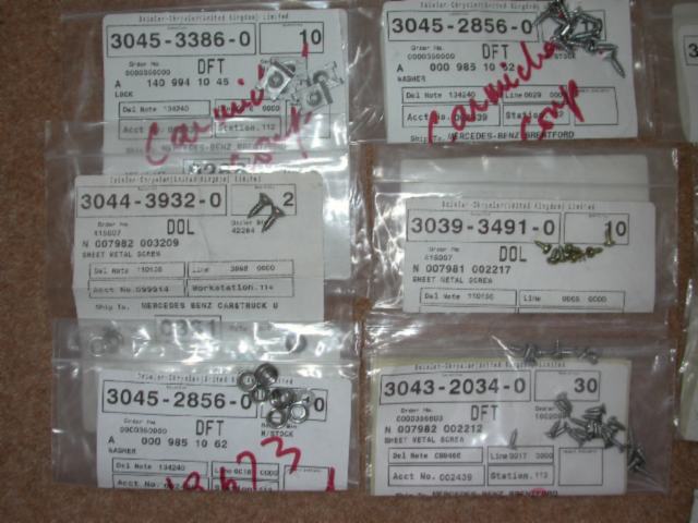

Here's some that may help
Download Attachment: HrdWre01.JPG
49.39 KB
Download Attachment: HrdWre02.JPG
48.19 KB

« Reply #12 on: May 06, 2005, 01:45:03 »
James,
Some cars have push clips and washers to hold the card board panels to the fire wall. My hardware picture #2, top 2 items in the right hand column.
I believe cupped washers are used with screws under the dash similar to the ones in picture #1, bottom left.

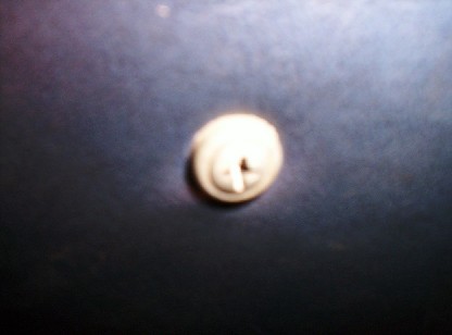

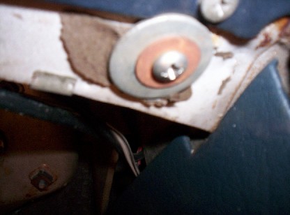

Well I decided to have a look. Many of the screws are still there -- even if the panels are not. It does appear that there are 7 front screws that hold on the panels, as Rodd's info suggested. Problem is, the screws seem a little hodge-podge. Only one had a cupwasher. Can anyone say that these look like the right ones? (oh, and had to fire the photographer...)

I would say this is right
Download Attachment: screw2.jpg
18.37 KB
and this is wrong
Download Attachment: screw4.jpg
25.67 KB
I suggest ordering the 7 screws/washers brand new with the below part numbers.  Putting my panels back on is on my long to-do list for June.  (May is yard landscaping and house cleaning.)  I'll probably be ordering screws.  Now, all the 280SL owners out there should probably look at your parts books to see if your hardware is different.
