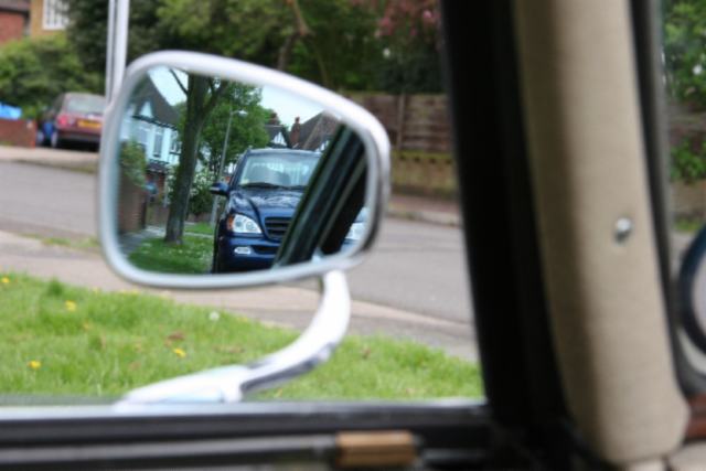

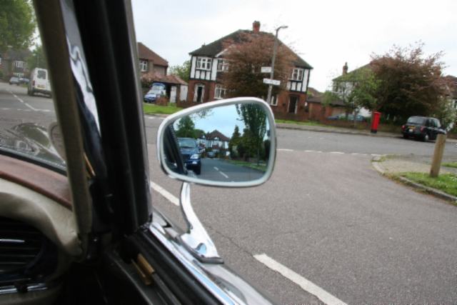

230/Early 250 Mirror Lens pictures:
Note the vertical line about one inch from the outer edge. Its a biconvex lens which removes the blind spot when a car is right next to yours.
Download Attachment: Mirror01.JPG
27.57 KB
Download Attachment: MirRH04.JPG
38.84 KB
Download Attachment: MirLH05.JPG
31.58 KB
Passenger Mirror Location:
I've now moved it further back. It was beyond the reinforcing plate inside the door, so I had to use a plate from a W111.
Download Attachment: MirLoc03.JPG
32.36 KB
Enjoy the view [:p]

« Reply #8 on: May 03, 2005, 21:47:13 »
Hi, Naj,
Nice looking job!  I'm amazed that you could find convex (or biconvex) glass that fix so well when cut.
I've sent my specs to Multivex and ordered a pair, so I'll let you know how heavy they are when they show up.  So far no old glass locally, but I guess I could probably have a local glass shop cut me a couple of clear pieces to order for less than shipping.  I'm out of town for a couple of weeks, so nothing will happen for a while.
