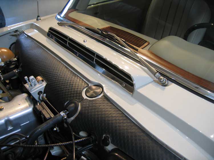

A frame up restoration presents numerous decisions including many that share the topic, "Refurb the original part or replace with a new one". Of the many choices I had to make on my recent project, one that stands out in my mind as clearly the right choice was to refurbish the firewall pad rather than replace it with new, aftermarket material.

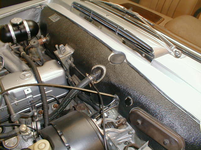

Fortunately, I was lucky enough to have original material that was capable of refurbishment. Encouraged by my restorer, we elected to salvage the original pad. It was carefully removed, the old backing scraped away, new backing pad was cut to fit and applied to the face 'skin', then a light coat of flat black spray paint finished it. Sure it took longer than replacing it with new material, but the visual result is very gratifying.
While my engine bay is by no means perfect, the opportunity to retain this very visual component was fortunate. All of this said to encourage those who may be entering a restoration to carefully assess the firewall pad and reuse it if you can. I believe it to be one of the small but significant successes of my recent project.

Very nice job! It is indeed good that you were able to rescue the original pad. I like the look and texture, wonder why noone has duplicated it, or at least noone currently.

"...engine bay is by no means perfect"? If that's the case, I could never post pics of mine. This one looks fantastic!

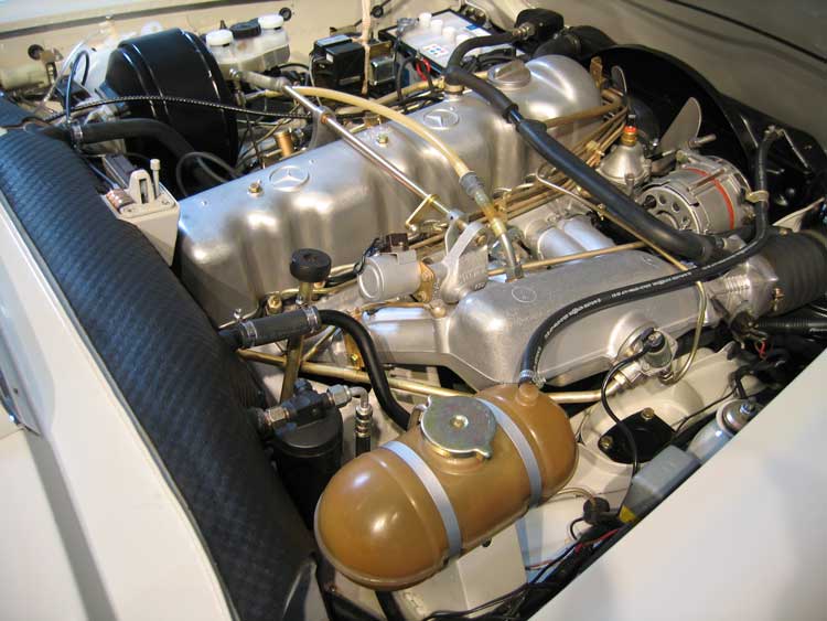

One question, are you keeping the new style brake fluid reservoir or going with the original type?  The only reason I ask is that I recently faced the decision as well and opted to go back to the orginal type.

Looks very nice indeed. I agree it was well worth the work of keeping it. Why is it that the original pad looks sooo much better?

Very nice job on the restoration.  You were very thoughtful on the firewall pad.  Wish I had known that the original material was not available before I replaced my pad.

Ed, the engine and its compartment look great!  The only thing I see that's missing are the plastic clips that go along the ridge above the firewall pad.  Outstanding job! :D

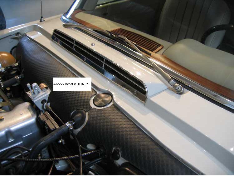

I re-used one of your pics to ask a question?

Bob, if you are talking about that brass springy thing, I always assumed it was to maintain ground/electrical continuity with the bonnet closed?

With regard to the brake fluid reservoir, the car currently has a new one installed but I definately kept the old one as I saw that part in particular as one I might want to switch back to original at some point. Not unlike the firewall pad, the new reservoirs don't really match the original look so I've left myself with that option.

Why would you need to "maintain ground/electrical continuity" with the hood? I think the springy thing is there to keep the hood from ratteling when closed and pop the hood open.

Yeah the semi-circular copper/brass spring thing on the hood latch unit.
Were they on all Pagodas?
I don't have one on my car and I don't really see the need for one.
Is it to do with static electricity or radio interference?
How is it attached to the hood latch?

I didn't suggest why one would need to have this continuity, only that my experience with these things indicate that that's what it looks like.  Unfinished spring brass is generally used for electrical continuity in moving parts.  Why is a question for an engineer.  If it were just springyness one was looking for there are better material choices then spring brass, but who knows?  Most old American cars do have a spring in the same general area to pop the hood up and prevent rattles, but they are generally big steel springs.  Maybe the aluminum in the hood only needs a gentle brass push?  I guess the questions to ask everyone is who has it and who doesn't, and whose hood pops up and whose doesn't, and whose rattles and whose doesn't?

Maybe these were installed on cars which came from the factory with optional radios? Mercedes installed "static ground straps" on the hoods of sedans of the era for this purpose. They prevented static electric interferance in the radios.

The contact spring is for radio suppression reasons.  The area it contacts on the "striker" plate should be bare metal.  It has nothing to do with opening the hood - it is too weak to perform such a purpose.  The little spring loaded rod just forward of the hood latch proper is what raises the hood.  It was part of every M-B hood latch until the W202 if I am not mistaken.

Vince is also correct about the radio suppression piece at the hood latch, however, I believe they were only seen on US-spec Pagodas.
