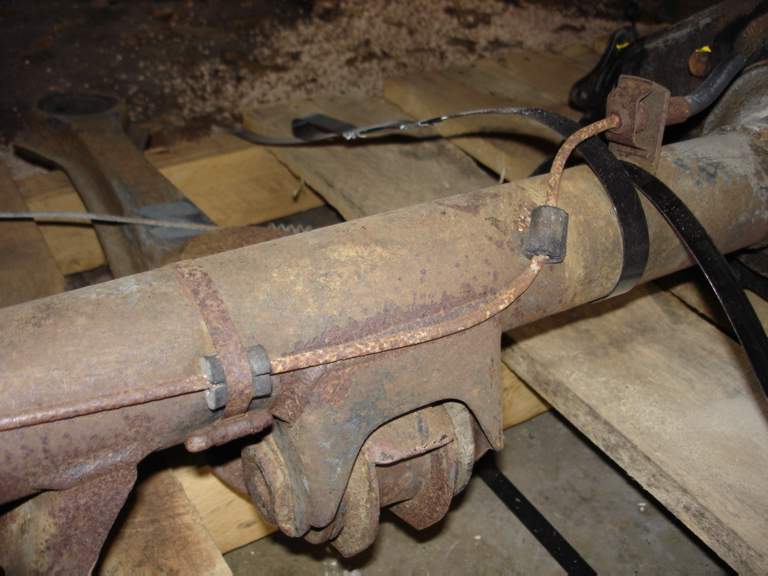

« Reply #6 on: April 26, 2005, 02:47:19 »
What about metal brake lines? Is there a test to find out when they should be replaced? (mine look somewhat corroded on the outside)
Download Attachment: brakeline.jpg
50.91 KB
Waqas in Austin, Texas
graphic66
Re: Brake fluid discoloration
« Reply #7 on: April 26, 2005, 05:34:56 »
Those are definitly pitted and the hose looks old too. It looks like that rearend is out. I think you should definitly replace those before installation. You could also clean and paint the axle before installing the brake lines and have a sharp looking unit.
