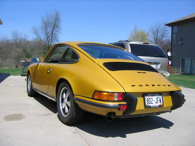

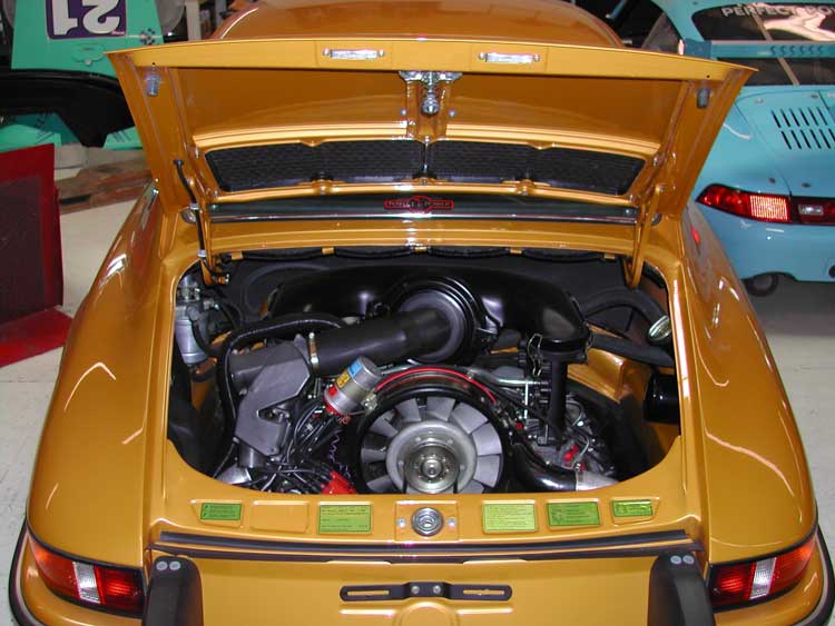

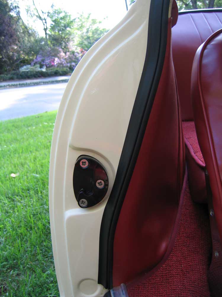

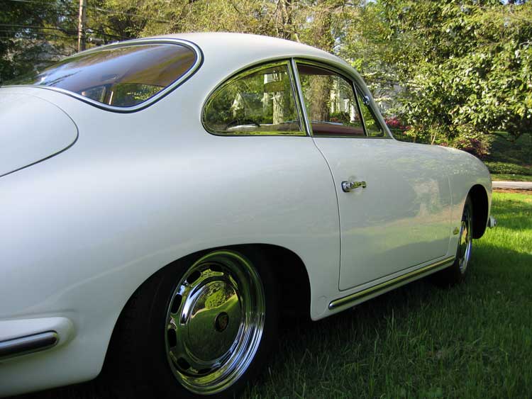

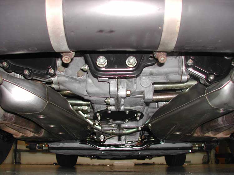

Yesterday I flew up to Madison, WI to look at (and ultimately purchase) a 1973 911S. I agree with you, this was definitely the last really good 911 for quite some time. They have become very collectable and are difficult to find, particularly in outstanding condition. I had been looking since about November and Brian Peters came across this one. Returning to Atlanta last night on the plane I recalled my test drive from earlier in the afternoon and a huge smile came across my face.
Unfortunately this means the 356 has to go.  :(  I can only accommodate two collector vehicles at one time. If anyone has an interest in it, let me know pretty quickly. A few pics of each are below.
Download Attachment: 73S-at-purchase.jpg
