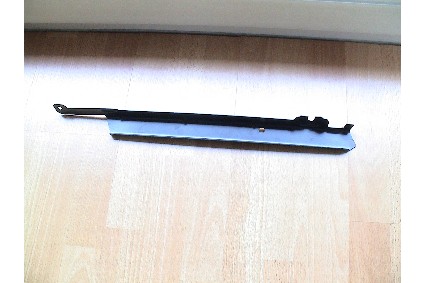

As I talked about with Naj at the Techno Classica Essen there where at both doorsides missing the rear water gutters of my car. Naj was surprised there were gutters at all, he didn't have them, so I was thinking maybe it's something that after restoring isn't replaced because it has no real purpose and nobody will notice after all. I looked up the parts# and is indeed described as wasserablaufschiene hinten 113 725 0768 or 0868. Anyone noticed the same missing of those parts?

Aah!! Paul,
Now that I know what they look like, they are indeed on my cars.
This picture shows the rear one. They actually fit with the two window channels.

[Paul,
I just replaced my drivers door and both the old and new one have the aluminum channels you show.  They attach to the window guide channels.  I don't know what the #'s are though I'm sure you can find them.  Check w/ Passarelli's in Cave Creek AZ.  I'll bet he has some good used ones. (ranchomerced@msn.com)

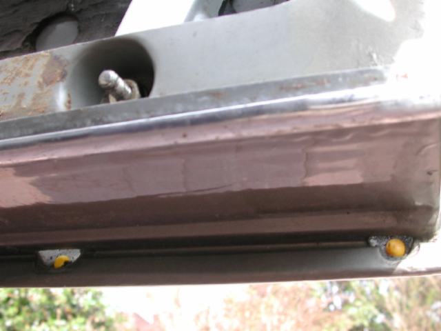

Found the door drain holes.
There are 7, around each of the (round ball) lower trip clips:
Download Attachment: DrDrain04.JPG
29.56 KB
TR

I'm still confused as to exactly where the "door rainwater gutters" (those in Pablo's photos) go.

Tom,
In this picture, the clean aluminum channel-like part is the rear rain gutter. Behind it (not visible) is a steel channel in which the bottom glass guide runs.
There is a similar one inside the front edge of the door.
http://www.sl113.org/forums/uploaded/naj/2005413125727_DrLck01.JPG
The front one can (just about) be seen in the bottom left corner of the door:
Download Attachment: DrDrain03.JPG
50.06 KB
