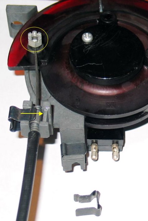

« Reply #5 on: May 03, 2006, 21:53:23 »
Originally posted by bpossel
... I will try this again...  not sure why I couldnt get these clips to "snap" back on the bracket?
Hi Bob,
by now you have probably figured out how the clips snap on but just in case here is a picture that may help.
Download Attachment: LeverCable.jpg
65.87 KB
Re: Climate Control Levers - Metal Spring Clip?
« Reply #6 on: May 04, 2006, 06:13:21 »
Hi Alfred,
Thanks!  Great pic.  Should help others who are "clip" challenged, as I was.  I was originally trying to force the clip on from the top, vs the side.  Nice pic, thanks again!
