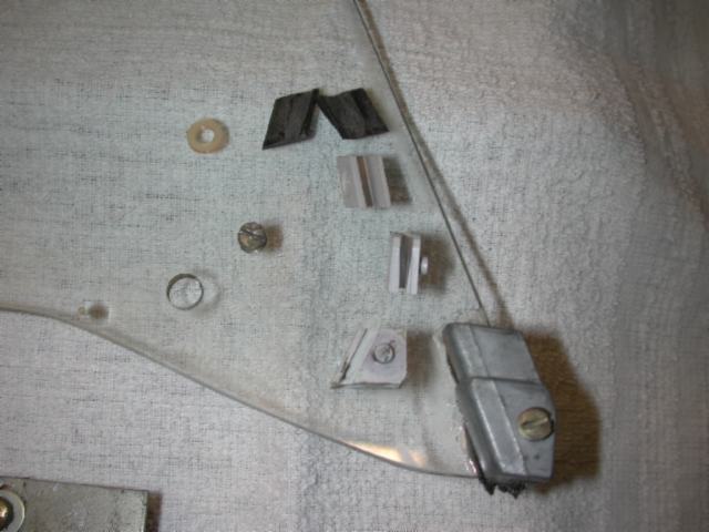

I would treat this job as a project and clean out the channels, replace the plastic runners and any other worn parts including the whiskers.
Download Attachment: DrGlass001.JPG
40.72 KB
Download Attachment: DrGlass003.JPG

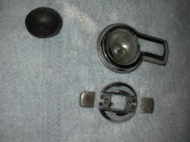

Juergen,
Here's the lock bits. Those little covers used to be chrome!!
Download Attachment: DrLck05.jpg
43.49 KB

aha! Now I know why I didn't see the second screw - looks like I have one of these sliding covers, the other is awol. Made me believe there is only one, namely the one that was visible. Excellent.

These covers just push fit into the grooves.

Well, to wrap up the panel-taking-offing: I slid off the slide-on thing, sure enough there was a screw, and after that I was able to take off the panel.
