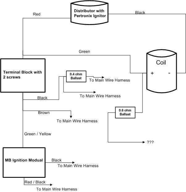

Hello All!
To continue with an earlier post regarding testing of the coil, I wanted to post another question to our group....
Keep the Pertronix Ignitor installed in my car, or go back to the original "factory" points?  I bought the car last summer, Pertronix was already installed, no documentation!  I have worked though all other areas, installing rebuilt injection pump, resetting all linkages to spec.  The car runs well in general, but I have a slight miss, sputter at idle.  Also have a slight miss at various different rpms.  I am like the rest of you...  seeking perfection is our cars!
I have attached a diagram that I made last night with how my Pertronix is installed.  Label on the Pertronix is: 09X-V4 CARB E.0 D-57 2.  There are a couple of the wires I can't trace all the way because they run into the "main factory" wiring, which I dont want to cut the outer insulation open.
I do have the aluminum distributor with part number 0 231 185 009 (JFU6).  Old Blue coil with 0.4 and 0.6 ohm ballast, as you can see in the diagram.  Also have the MB Transistorized Ign Module that sits under the battery...
So, should I keep the Pertronix and try and resolve, or go back to the original setup?
Thanks for all your comments and suggestions!

I think you need 12 volts at the red of the dist.you have to bypass the ballast resistor
